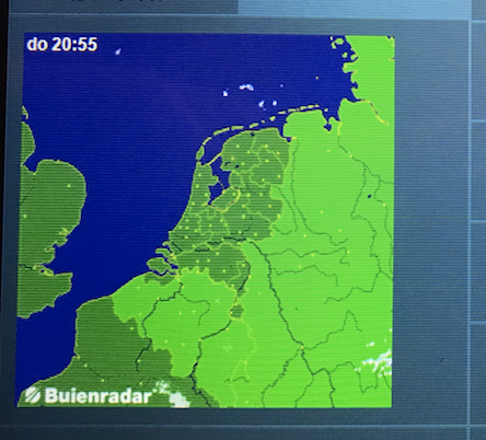

See screenshot, is it possible to zoom in on the Buienrader picture so that I only see my city and around?

this looks promising. Please explain further. Do I need to change this button to a frame?
buttons.buienradar = {width:12, isimage:true, image: 'http://api.buienradar.nl/image/1.0/RadarMapNL?w=285&h=256', url: 'http://www.weeronline.nl/Europa/Nederland/Son/4058667'}

I have a frame :
frames.buienRadar = {refreshiframe:300000, width:5, height:550, frameurl:"https://gadgets.buienradar.nl/gadget/zoommap/?lat=12.34567&lng=2.3456&overname=2&zoom=8&naam=test&size=3&voor=1"}
(removed my location information)

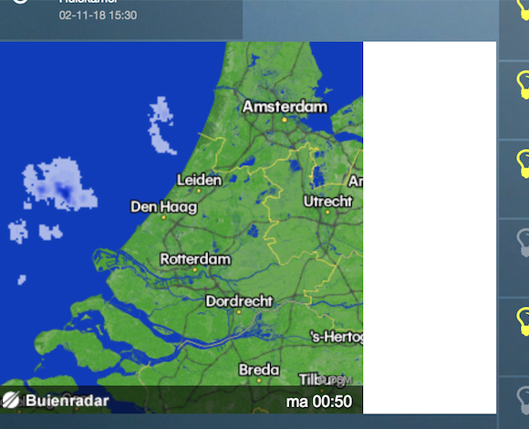

I'm using the following line regarding the zoom in into my area:
frames.buienradar1 = {refreshiframe:30000, width:12, height:550, frameurl:"https://gadgets.buienradar.nl/gadget/zoommap/?lat=52.05036&lng=4.37942&overname=2&zoom=8&naam=2496HX&size=2b&voor=1"}
But I'm getting an ugly with bar to the right, see screenshot. How to resolve this? I've been playing around with the various size numbers but I cannot get something nice.
