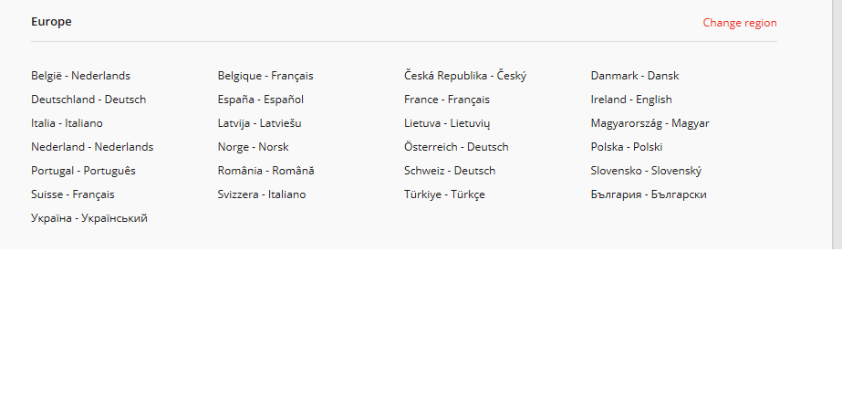

Just to be sure: Changing the portal language settings...I changed my country to Hungray in my profile, language to Hungarian in my profile, but the web interface is still English (see attachment). Is this all as it should be? It's really driving me nuts...!
- Untitled.png (12.95 KiB) Viewed 4660 times

AFAIK Hungarian is the wrong setting. This is likely caused by Hungarian (and other languages) having non-ASCII-7 characters and the portal trying to reinterpret what it is receiving. Choose English.

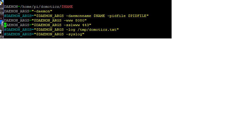

Ok, so I really f#cked my whole Domoticz and pi up trying to enable debugging. Did a clean install, restored database, up and running again.
I know I have to add some arguments to domoticz.sh, but can't figure out what exactly. I tried several options, but they all resulted in either no logging at all, or no more erros.
What should I add to my domoticz.sh?
It currently looks like as attached (default after clean install).
Thanks a lot for the patience!
Johan
Johan
- Untitled.png (18.45 KiB) Viewed 4623 times

This should do it:
DAEMON_ARGS="$DAEMON_ARGS -loglevel 15 -debuglevel normal"
