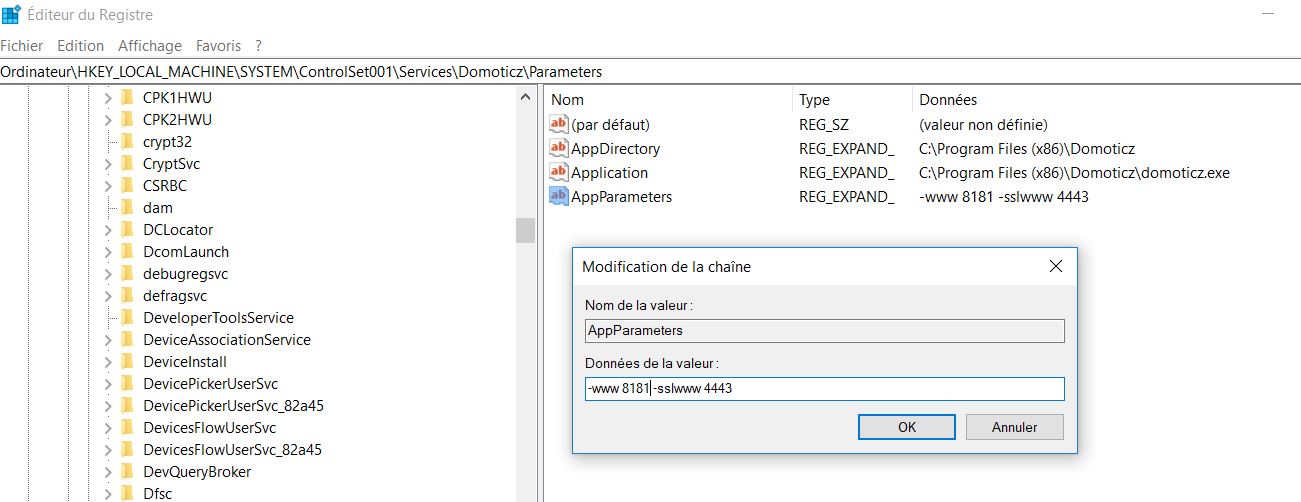

Just tested on my installation on it's work:
- Capture.JPG (92.69 KiB) Viewed 2638 times

Thanks for your answer. I've tried it again. But now deleted Domoticz. The port is the right one in the registry. But the application doesn't answer to it and keeps on answering on the old one!
