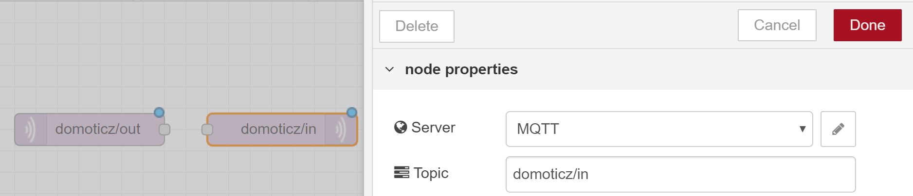

Run a separate local only MQTT server on one of the Domoticz boxes, use Node-Red to subscribe to it and re-publish it to another MQTT topic.
See how you can change the topic it routes into on the main MQTT server?

Not the best solution I know, I don't think what you want to do is possible without changes to the Domoticz MQTT code, as you say everything is going to the same channel.
