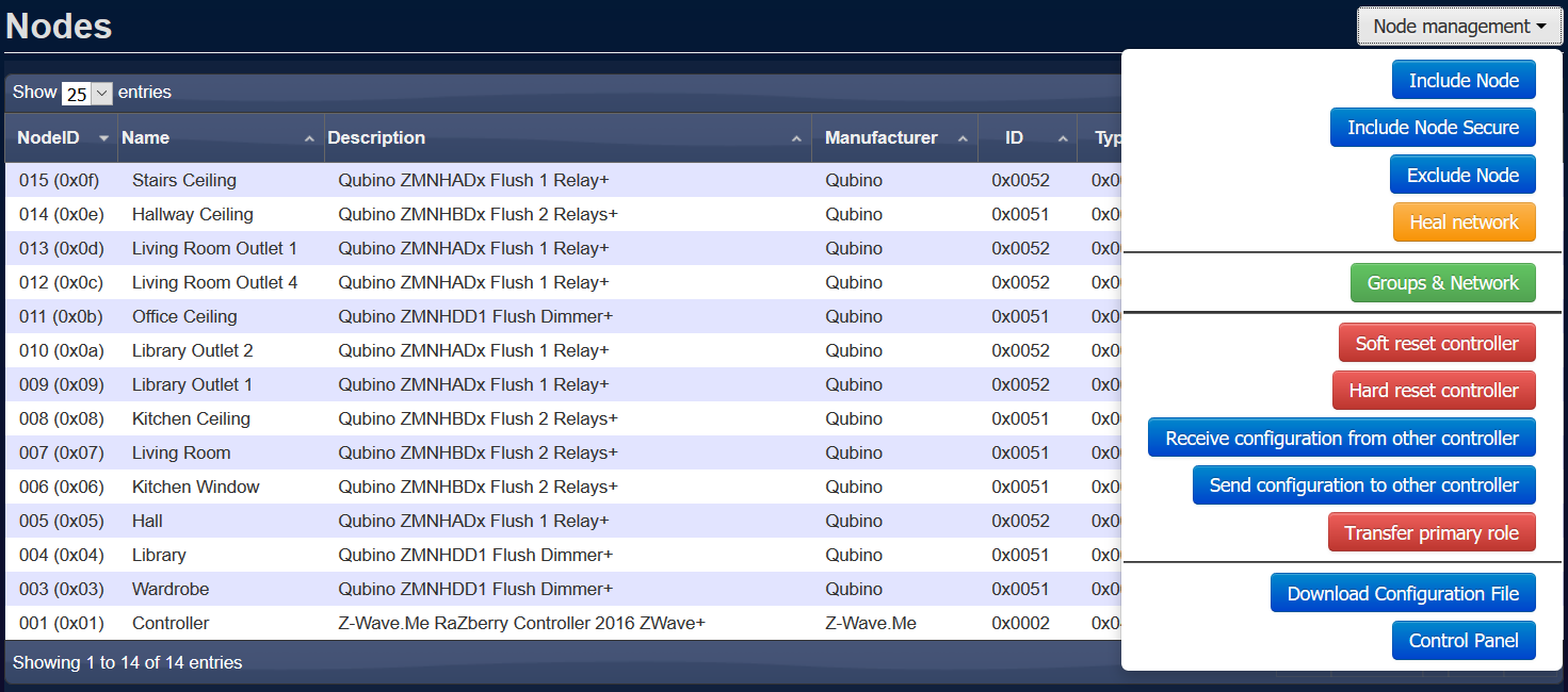

The above will only include the device in the device list of Domoticz and for the proper inclusion of zwave device you need to go to the Hardware section and you should then have a Setup button for the zwave controller. Click this and you'll get to a new screen where you have Node Management button where you can choose to include devices or even better choose to make use of the OpenZWave GUI instead by clicking Control Panel under Node Management.
