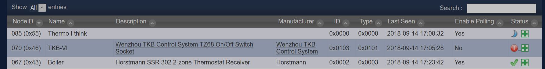

Hi All,
I'm having real problems with getting my Secure SCS317 (aka Horstmann SCSC7) thermostat into the z-wave network properly.
It's a real pain to include, works about one time in five and has to be done with the z-stick off the PC, has never succeeded via domoticz or ozwcp. Once it is included, the SCS317 shows a network connection and I can associate it (using its UI) with the boiler control relay. However, it shows up in the OZW device list as an unnamed device - image below - and whatever I try, I just can't get ozw to pull any info from it. Mfr & Dev IDs remain stubbornly 0x0000.
The two devices are about 6ft apart. To get the SCS317 included, I held the z-stick between my fingertips, about 20cm from the device - and even then it was fourth time lucky!
It seems to include more easily on a z-stick S2 than on the newer Gen5 stick - and ozwcp does recognise it when it's using the S2. I wonder whether there's a problem with this device and the Gen5. Has anyone got this combination working and can help?
Secure's support are pointing to the z-stick, not unreasonably (the SCS worked with Vera ok too); Aeotec have yet to reply to my email :(
I've also removed the SCS317 from the ozwcfg xml file and let the system find it again, but that makes no difference; that suggests to me that the problem is more likely between the z-stick and the SCS317. I've tried asking ozw / domo to heal the device while having it in 'listen' mode (stay-awake), removing and re-including, sending NIFs, everything I can think of. Nothing shows up in domoticz.log for the device ID when I have the SCS317 send a NIF, which is strange, yet the thing is clearly in the z-wave network as it can associate with other nodes on the network (the boiler relay, which you can see in the screenshot is already part of the z-stick's network). After a while, OZW will decide to deem it a dead device.
Does anyone have any suggestions / ideas what the problem might be or what I can try to diagnose it?

Update... looking at the zwcfg xml file, after my latest efforts there are now some command classes for a thermostat under that device but it still has 0 in the mfr id and device type fields. Slightly randomly, just one switch device has come through into the domoticz UI from it. Very odd.

Thought it was worth trying to force the device detection by editing the zwcfg...xml, so I put in the device info (mfr 59, device 0004:0001) and restarted domoticz.
Success! :-) After a fashion and a bit of sending NIFs, the offender now shows up as a Horstmann SCSC-17 and I have a setpoint, a current temperature and a switch. Hallelujah!
