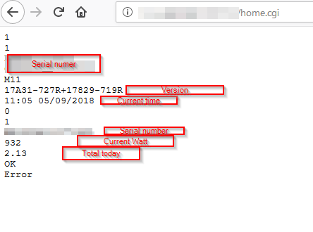

There is also a local web interface that this perl script use to load the information from. Is there a way to import this into domoticz or retrive the information directly into domoticz? There is a cgi page that gives the following;

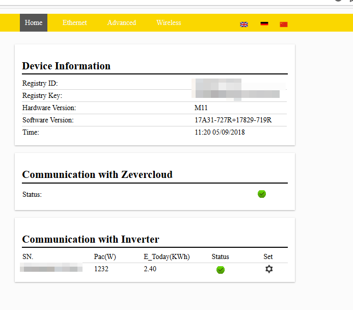

The main status page gives the following and is used by the script that smeyn has on github;

I've made some code to read the inverter.

               local PacW = lines[11]
               local E_Today = lines[12]
               local Status = lines[13]
