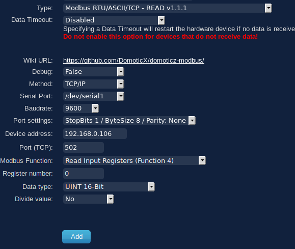

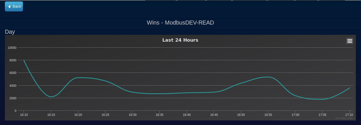

Hello everyone,
I read a Windspeed Sensor via Modbus TCP (the Readout is 0-65536 = 16Bit) --> 0m -->50m/s
The Readout works fine but the "Divide Value" is fixed to /10 /100 /1000.
How can i scale the Value Correct?
Many Thanks!
