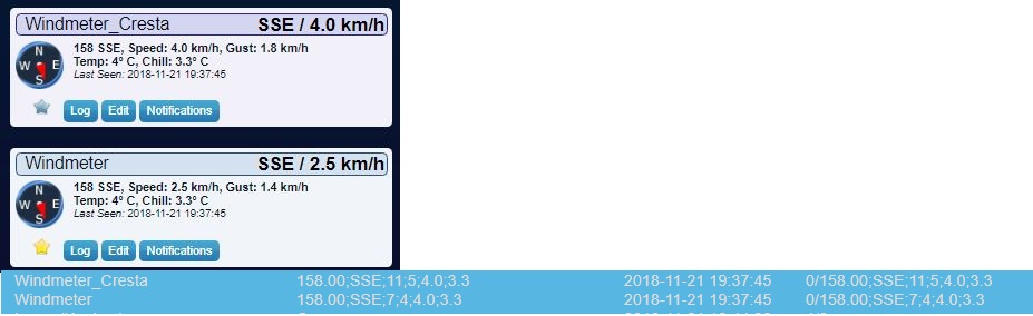

Ruud v Gessel's "Cresta weather sensor protocol" describes Windspeed and Windgust as mph. As I can see RFLink passes sensor mph value as kmph to domoticz, rfxcom passes calculated kmph from sensor mph. Regards Götz

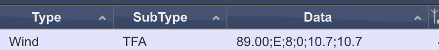

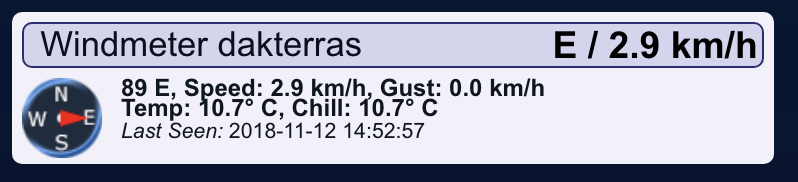

Domoticz seems to do something different here:
It gets '8' as data: And displays '2.9 km/h' The code has this:
Why does domoticz think the data is in decimeters/second?

In Domoticz speed expressed as 0.1m/s is aspect of definition.
See https://www.domoticz.com/wiki/Domoticz_ ... L%27s#Wind
Only reason I could imagine, is that then the practical transfer values can be expressed as integers.

So is the '8' in the data overview the value read from rfxcom (presumably in km/h) or the processed value? I ask because the '8' is a lot closer to the 10km/h from the local weather report than the 2.9km/h domoticz displays.
I don't have a different (calibrated) anemometer to compare against, so domoticz could be doing the right thing already.

- the readout c) through the RFLinkGateway [in my case R46] shows much lower values [meanwhile this 'possible bug' reported to Stuntteam], possibly (?) a factor 1.6 due to output as mph vs. kmh
Furthermore, (similar to reported by sincze) generally the values coming from my TFA_Nexus' anemometer are lower than those coming from a co-located WS7000-anemometer (which I better trust, because better quality, although aged).
Just raises the question: which wind speed is true & correct?
Which interface are you applying to read the TFA_Nexus anemometer?
By accident (while looking for something completely different) I can confirm the observation by ds106 that in Domoticz it seems to make difference over which interface you read windspeed from TFA_Nexus
a) over the Console's TE923 USB-interface, or
b) wireless by RFXCom or
c) wireless by RFLinkGateway:
- the readouts a) and b) from the TE923-interface, respectively from the RFXCom usually agree
