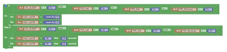

The blocky version are working and its basically the same.
Re: What am I doing wrong here?
Melotron wrote: Thursday 16 August 2018 20:51 The blocky version are working and its basically the same.
Not quite... I see two or's in the blockly and only one in your first dzVents script

Yes, the last PIR are removed from the dzvent script as I haven't set it up after we repainted the wall.
Going to do that this weekend.
