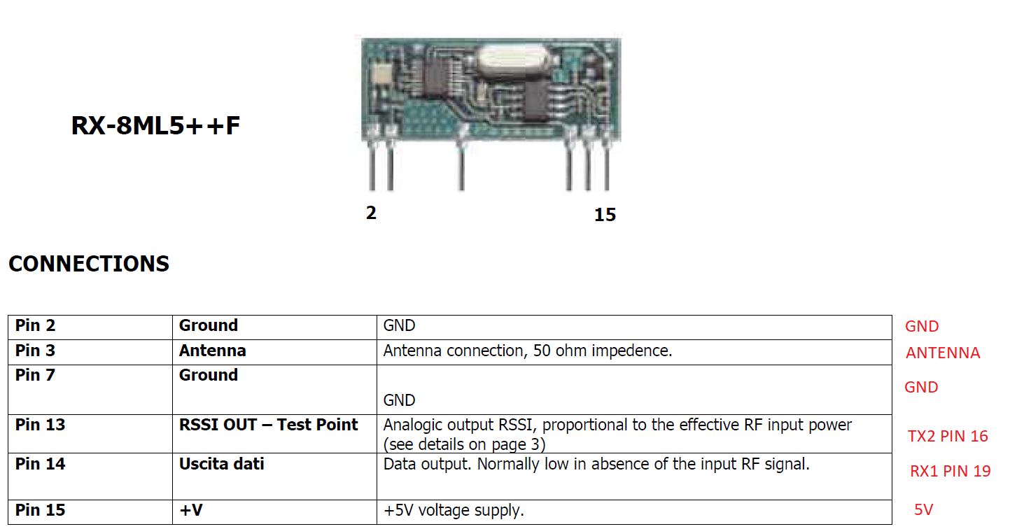

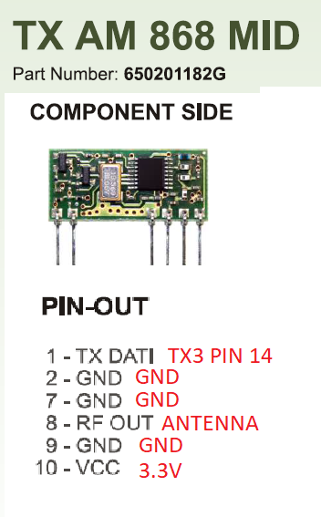

I already have a 433MHz RFLink and it works properly, I read that we can't use 433 and 868 on the same Arduino board, so I bought a new Mega Board and these Aurel 868MHz modules : RX-8ML5++/F and TX-AM868-MID, I tried to wire these modules but it seems to don't work properly.. On the log window no communication appears...
I give you my wiring detail in red color in attachments (I use different antenna, I see that's needed for Aurel module)
So what's my mistake ? How can I wire the modules ?
