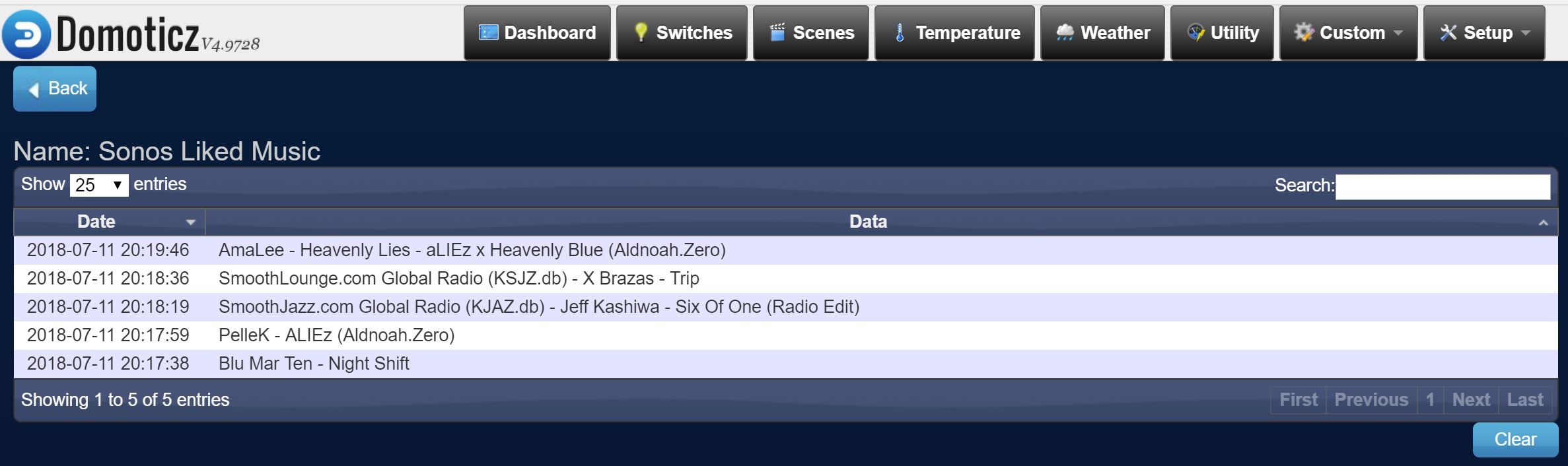

This is a bash script I wrote to write the currently playing track or radio station of a Sonos system into a Domoticz text sensor.
Essentially it's a way you can "like" whatever music is playing and save it to Domoticz so you can easily look at it later if you want to add it to Spotify or Google Music etc..
Personally I have a Wallmote button allocated to "liking" music in the living room. Makes my life easier, I don't have to open the Sonos App and often screenshot the name of a track playing on an internet radio station, the artist and track name are recorded to Domoticz!

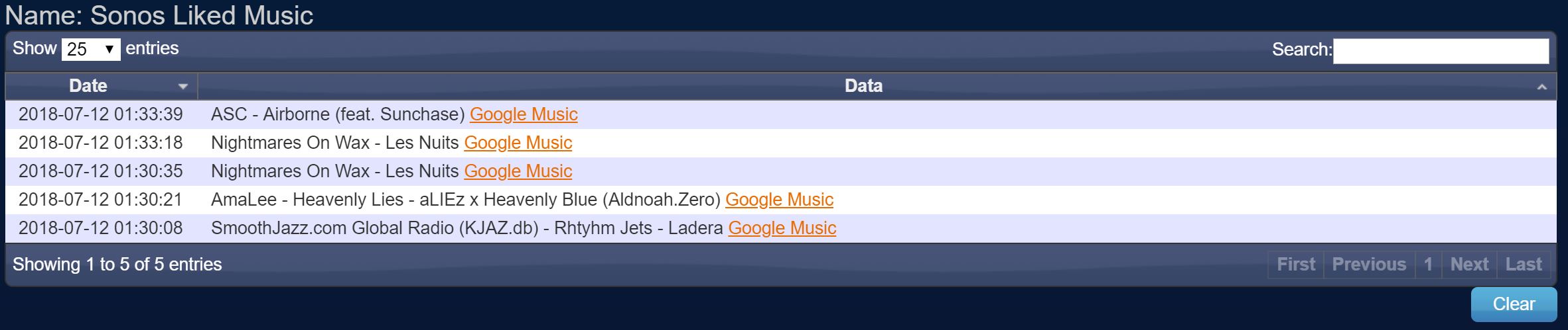

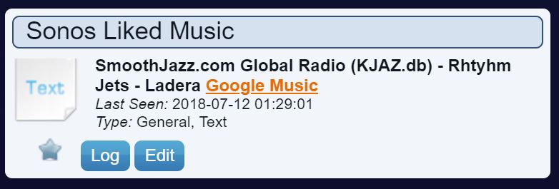

Modified version that hyperlinks a Google Music search for the track name (it's smart enough to exclude the name of an internet radio station if one is playing). 8-)
