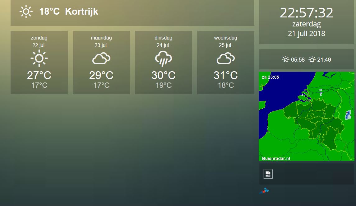

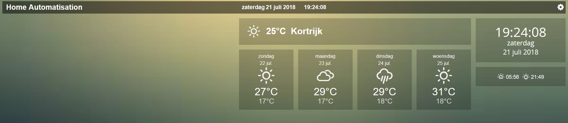

Gianni
- Posts: 230
- Joined: Saturday 21 July 2018 19:03
- Location: Home@Belgium
Re: Settings not saved on RPi
i got the same problem.
pi3 follow the wiki to install.
New folder on WWW
chmod 777 config.js
but i cannot save my settings with the gear method.
I edit my config.js manual but i cannot get i full working.
I got no clock no maps only the weather
Took the default config file from the wiki page.
New folder on WWW
chmod 777 config.js
var config = {}
config['language'] = 'nl_NL';
config['domoticz_ip'] = 'MY IP AND PORT;
config['user_name'] = 'MY LOGIN
config['pass_word'] = 'MY PASSWORD';
config['loginEnabled'] = 1;
config['app_title'] = 'Home Automatisation';
config['default_news_url'] = 'http://www.nu.nl/rss/algemeen';
config['news_scroll_after'] = '7';
config['standby_after'] = 0;
config['auto_swipe_back_to'] = 1;
config['auto_swipe_back_after'] = '10';
config['auto_slide_pages'] = 0;
config['slide_effect'] = 'slide';
config['standard_graph'] = 'month';
config['timeformat'] = 'DD-MM-YY HH:mm';
config['calendarurl'] = 0;
config['boss_stationclock'] = 'RedBoss';
config['gm_api'] = '';
config['gm_zoomlevel'] = 0;
config['gm_latitude'] = 0;
config['gm_longitude'] = 0;
config['wu_api'] = '';
config['wu_city'] = 'Kortrijk';
config['wu_name'] = '';
config['wu_country'] = 'BE';
config['idx_moonpicture'] = 0;
config['switch_horizon'] = 0;
config['host_nzbget'] = '';
config['spot_clientid'] = '';
config['selector_instead_of_buttons'] = 0;
config['auto_positioning'] = 0;
config['use_favorites'] = 1;
config['last_update'] = 1;
config['hide_topbar'] = 0;
config['hide_seconds'] = 0;
config['hide_seconds_stationclock'] = 0;
config['use_fahrenheit'] = 0;
config['use_beaufort'] = 0;
config['translate_windspeed'] = 1;
config['static_weathericons'] = 1;
config['hide_mediaplayer'] = 0;
config['settings_icons'] = ["settings", "fullscreen"];
config['shortdate'] = 'D MMM';
config['longdate'] = 'D MMMM YYYY';
config['shorttime'] = 'HH:mm';
config['longtime'] = 'HH:mm:ss';
config['weekday'] = 'dddd';
config['no_rgb'] = 1;
config['standby_call_url'] = '' ;
config['standby_call_url_on_end'] = '' ;
config['hide_off_button'] = 1;- HansieNL
- Posts: 994
@Gianni: You have set config['auto_positioning'] = 0; , so you have to add the blocks, columns and screens to your config.js yourself. How to do that can you find in the wiki https://www.domoticz.com/wiki/Dashticz_V2_-_Positioning

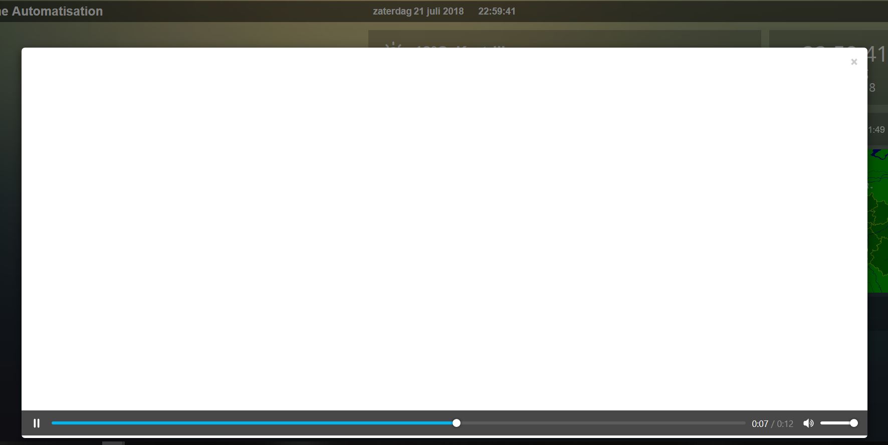

HansieNL thx allready play with some setting but it's my first day with Dashticz.HansieNL wrote: Saturday 21 July 2018 22:24 @Gianni: You have set config['auto_positioning'] = 0; ,/url]
Need to sort out how to arrange the predefind buttons first
And if i push the button it opened a web stream what is good but i dont need the popup so i need to find how to start the stream docked but now i hijacked some other thread i will look further or open a new topic later.
But the point is that when i changed something in the settings with the gear button and i refresh dashticz the setting are back to default so it's not written to de CONFIG.js
