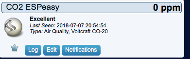

ESPeasy with MH-Z19B CO2 device is showing CO2 values, the virtual Domoticz device is being updated (timestamp is changing according to ESPEasy settings) but CO2 value remains zero.
Connecting to Domoticz via HTTP or MQTT, both give the same results :cry:
I have tried all the obvious, update, upgrade, reboot but so far no luck. What could be the problem?

Of course I doubled, doubled checked the idx of the CO2 sensor (1951)

When you are running the standard ESPEASY MHZ19 code and use HTTP to update domoticz, you need to make a rule to do the update as the ESPEASY device definition is a 3 value sensor, which sends the wrong information to domoticz.
In this topic i've explained my setup and also defined the rule required: http://www.domoticz.com/forum/viewtopic ... 20#p156773

Thank you very much Jos, applied the following steps on the ESPEasy:
-Tools, advanced, check rules, Submit
-Devices, edit MH-Z19 sensor, memorize Name :D (in may case CO2), uncheck Send to Controller, Submit
-Rules: add
on CO2#PPM do
 SendToHTTP,192.168.2.30,8080,/json.htm?param=udevice&type=command&idx=1951&nvalue=[CO2#PPM]
endon
Submit.
and the CO2 levels are showing up in Domoticz. Great!
