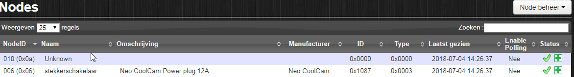

I'm new to domoticz. I've bought a z-wave smoke detector on Aliexpress: https://nl.aliexpress.com/item/Z-wave-S ... 4c4dUBhgQi
I've added it to my hardware list, but the information is not showing. So I can't work with it to start building actions.
2018-07-04 14_26_42-Domoticz.png (24.47 KiB) Viewed 773 times
I've pushed the test button to maybe make it show up, but that hasn't worked.
Does anyone have tips what i can try to make it work?

I've found the solution.
*) exclude device
*) include device
*) then when you've reconnected the Z-wave dongel
*) go to settings, press allow adding for 5 min
*) test the device (sound the alarm) and repeat the include procedure (press small button 3 times)
*) repeat the previous two until you see the smoke detector added in de list
