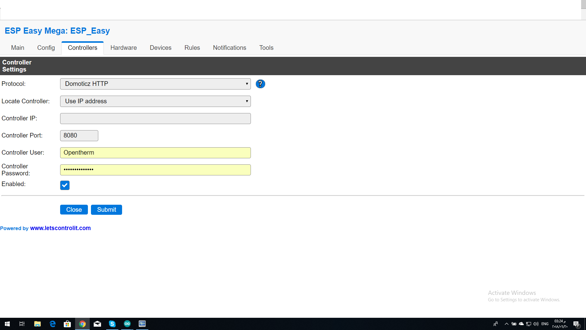

can you show me in an example with the code and what about using generic http doest that work ?
- Untitled.png (104.14 KiB) Viewed 11966 times

That screen capture is the domoticz server setup. You simply fill in the ip address of your domoticz server in the "controller ip" field and only the UserId & Password when required by domoticz.
Then go into the device configuration and fill in the IDX of the Sensor/Device which you can find in domoticz.
How does the device config screen look in ESPEASY?
How does the device config that needs to receive the information look in Domoticz?
