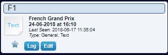

This script gets the next F1 race from https://ergast.com/mrd/ and writes it to a text sensor.
Ergast offers more info on F1 - I need a race in progress to see if it provides live position information.
		timer = { 'at 10:00' },
		httpResponses = { 'nextF1' } -- matches callback string below
        data = {
            nextF1 = { initial = nil }
	execute = function(domoticz, triggerItem)
		if situation == 'CET' then -- check for DST
			 offset = 1            -- offset for timezone Madrid Winter time
         else offset = 2           -- offset for timezone Madrid Summer time, change these values to match your timezone
    local board = domoticz.data.nextF1
	local sensor =  domoticz.devices('F1')
		if (triggerItem.isTimer) then
			domoticz.openURL({
				url = 'https://ergast.com/api/f1/current/next.json',
				method = 'GET',
				callback = 'nextF1'
		elseif (triggerItem.isHTTPResponse) then
			local response = triggerItem
				if (response.ok and response.isJSON) then			--when a valid json is received do this
				 local name = response.json.MRData.RaceTable.Races[1].raceName
				 local fechapura = (response.json.MRData.RaceTable.Races[1].date)   --get the date as provided(YYYY-MM-DD)
				    --Next line converts it to DD-MM-YYYY, you can delete it if you are OK with provided date format
				  local YY = string.sub(fechapura, 1,4); local MM = string.sub(fechapura, 6,7); local DD = string.sub(fechapura, 9,10); local fecha = (DD..'-'..MM..'-'..YY)
				 local horapura = (response.json.MRData.RaceTable.Races[1].time) --get time as provided (GMT without offset for DST)
				  --convert provided time to time in your timezone
				  local HH = (string.sub(horapura, 1,2) + offset); local MM = string.sub(horapura, 4,5); local hora = (HH..':'..MM)
				 local race = (name..'\n'..fecha..' at '..hora)
				 	 if board ~= race then              --Only update text sensor if current info is different from the stored info
				 	  sensor.updateText(race)
					  domoticz.data.nextF1 = race       --write the new info to global variable
						print('**nextF1 failed to fetch info')
				end													--end of actions after valid json received

Cool, i like this one as a F1 fan. Will give it a try this evening
Edit: Already implemented, works great. Many thanks for it

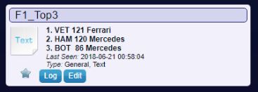

If you mean the season ranking Top 3:
		timer = { 'at 0:58', 'every 15 minutes on sat, sun, mon' },
		httpResponses = { 'F1-Top3' },
		devices = {'F1'}
    local board = domoticz.devices('F1_Top3')    --a virtual text sensor
    local prevboard = tostring(board.text)          --get current value of text sensor
			domoticz.openURL({
				url = 'https://ergast.com/api/f1/current/driverStandings.json',
				method = 'GET',
				callback = 'F1-Top3'
			local pInfo = ''
			local bInfo = ''
			tl = 3
			tc = 1
			repeat
				local code = tostring(response.json.MRData.StandingsTable.StandingsLists[1].DriverStandings[tc].Driver.code)
				local points = tostring(response.json.MRData.StandingsTable.StandingsLists[1].DriverStandings[tc].points)
				local const = tostring(response.json.MRData.StandingsTable.StandingsLists[1].DriverStandings[tc].Constructors[1].name)
				local pos = tostring(response.json.MRData.StandingsTable.StandingsLists[1].DriverStandings[tc].position)
				 if string.len(points) < 3 then points = (' '..points) end
				local Full = (pos..'. '..code..'   '..points..'   '..const..'\n')
				tc = tc + 1
				pInfo = (pInfo..Full)
			until tc == tl + 1
				print(pInfo)
					if bInfo ~= prevboard then
						board.updateText(pInfo)
					print('** F1-Top3 failed to fetch info')
For the Qualify, I don't think Ergast provides that info. Have a look for yourself at https://ergast.com/mrd/ maybe you find something useful there.

Name of the virtual Text sensor is set in
"local sensor = domoticz.devices('F1')" for the first script
In the second on (F1-top3) : local board = domoticz.devices('F1_Top3') --a virtual text sensor
For the 3rd one (qualify) : local qboard = domoticz.devices('F1_Qualy3')

Derik wrote: Monday 10 September 2018 21:03 Perhaps possible to show place 4 and 5 also??
Perhaps we can see MAX :-)
Improved version :-)
		timer = { 'at *:22', 'every 15 minutes on sat, sun, mon' },
		devices = {'F1'}
			domoticz.openURL({
				method = 'GET',
			local pInfo = ''
			local bInfo = ''
			tl = 5
			tc = 1
			repeat
				tc = tc + 1
			until tc == tl + 1
					if pInfo ~= prevboard then
In this example the 5 first in the ranking are fetched: Line 25 (tl = 5) change the number to match your needs.
