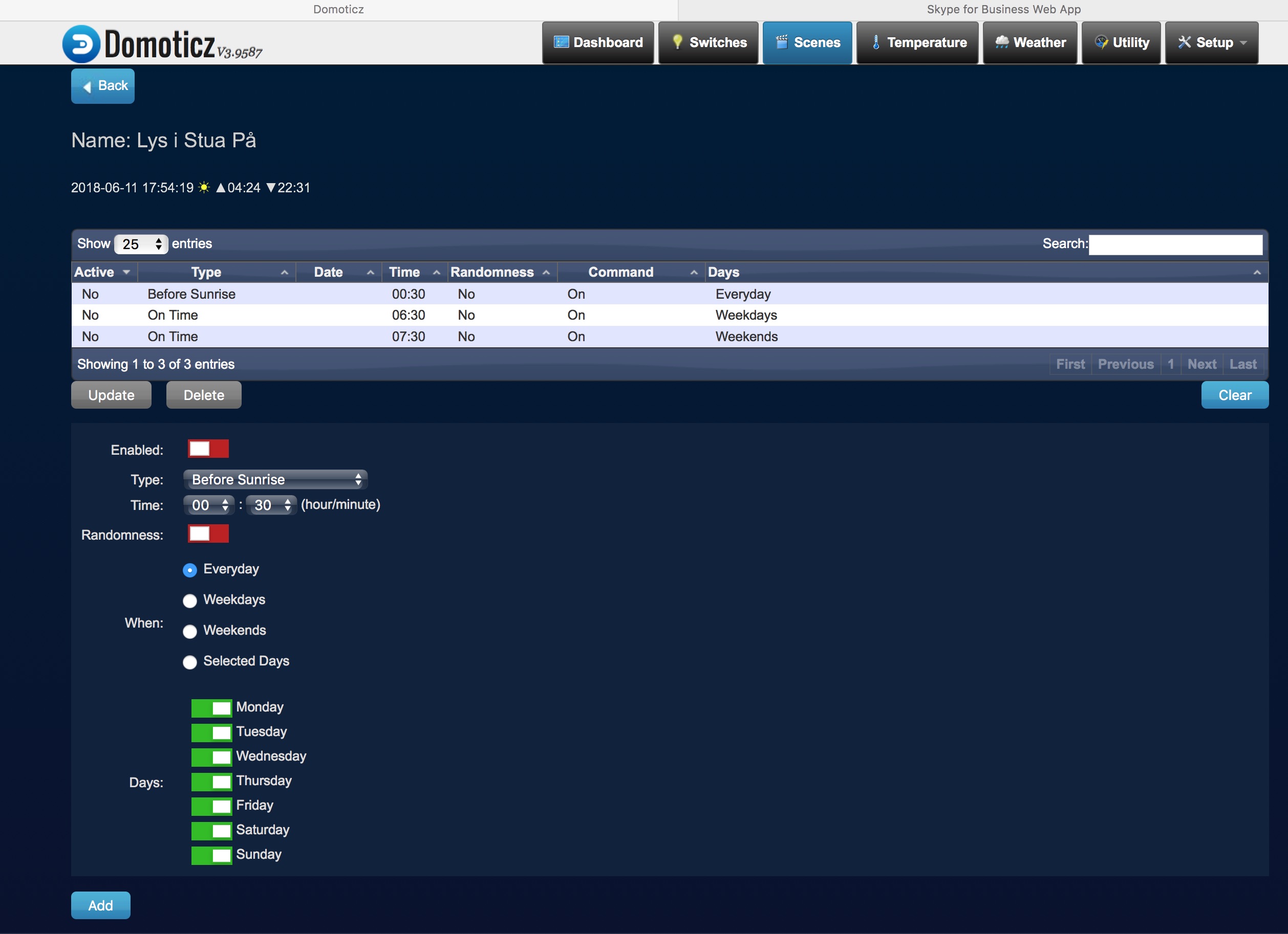

I have a scene with 3 timer entries.
In summertime I want to disable all 3 entries.
A couple of hours after i disable the timer entries, they get re-enabled automatically.
Why is this happening and how can I prevent it?
screenshot 2.jpg (355.14 KiB) Viewed 884 times

I assume you use JSON to disable the timers? Can you post them here?

I only use the web GUI.
Re: Disabled scenes automatically re-enables
Do you have multiple timerplans ?

Set a scene timer to disabled yesterday evening and it still is disabled. Maybe @waaren is right and do you have multiple timer plans interfering with eachother.
