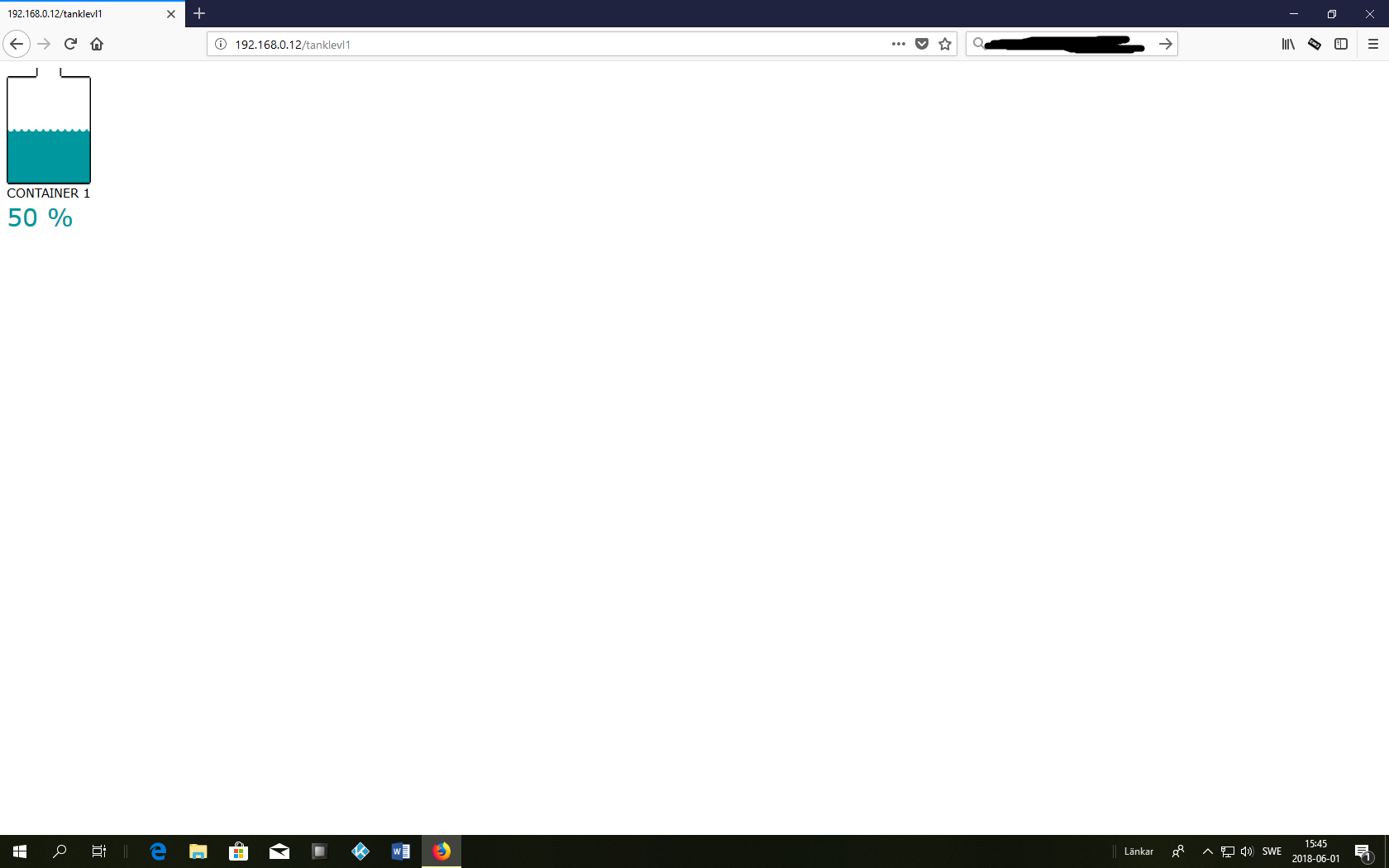

Hello, im new to domoticz,
i have built an irrigation system with denkovi hardware and a tanklevel measuring with arduino.
the tanklevel have a kind of simple webserver that i can reach from ip or dynamic dns (no ip) when not at home. i will try to upload picture.
is it possible to show this in domoticz as well??
- picture of tank level
- tanklevel.png (81.18 KiB) Viewed 4663 times

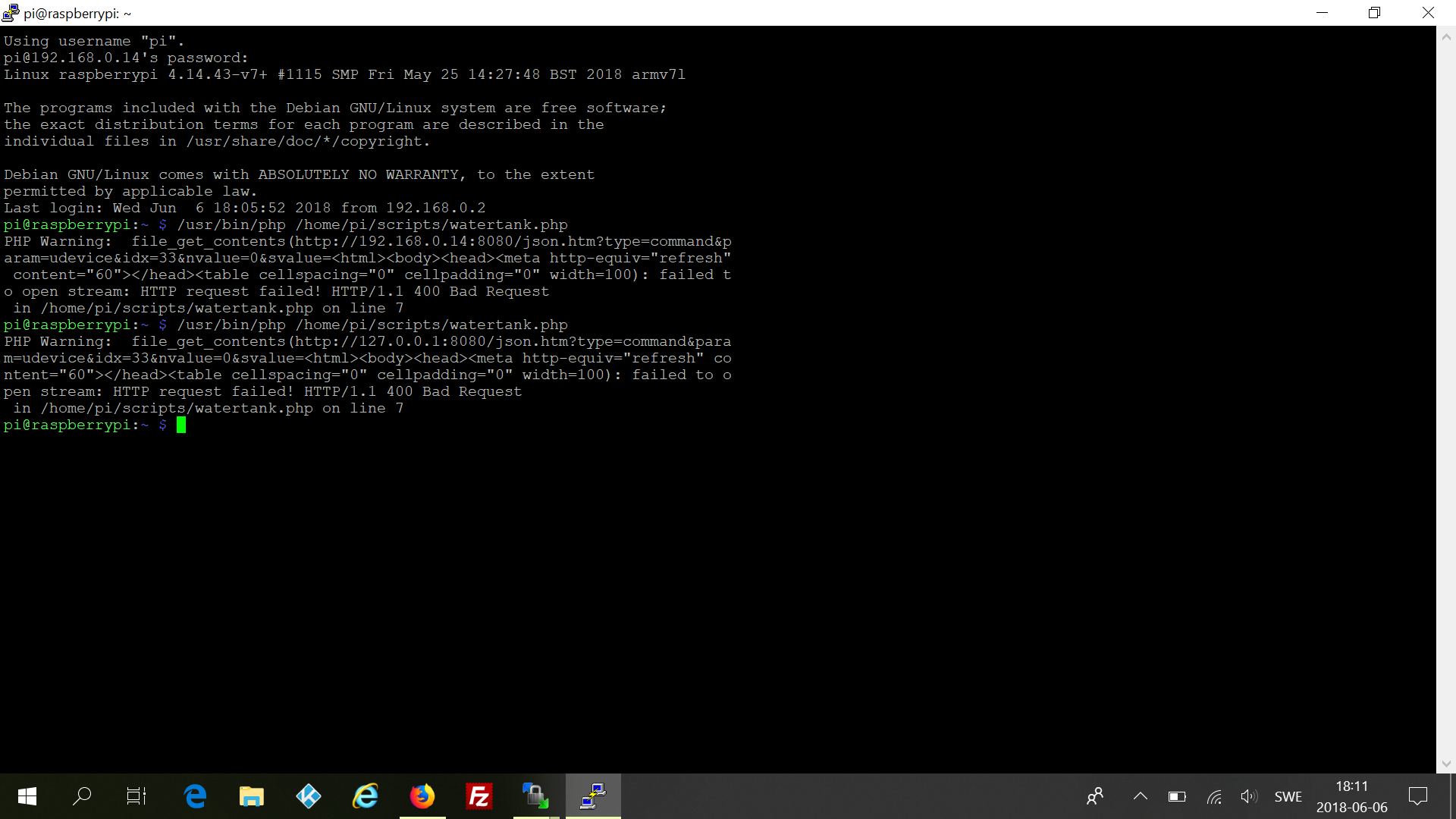

Hi, couldn give up,
i installed php on pi but still get this error in line 7, can you tell me how to write the line if i have ip 192.168.0.14:8080 ?
should this [::1] be together in line somewhere?

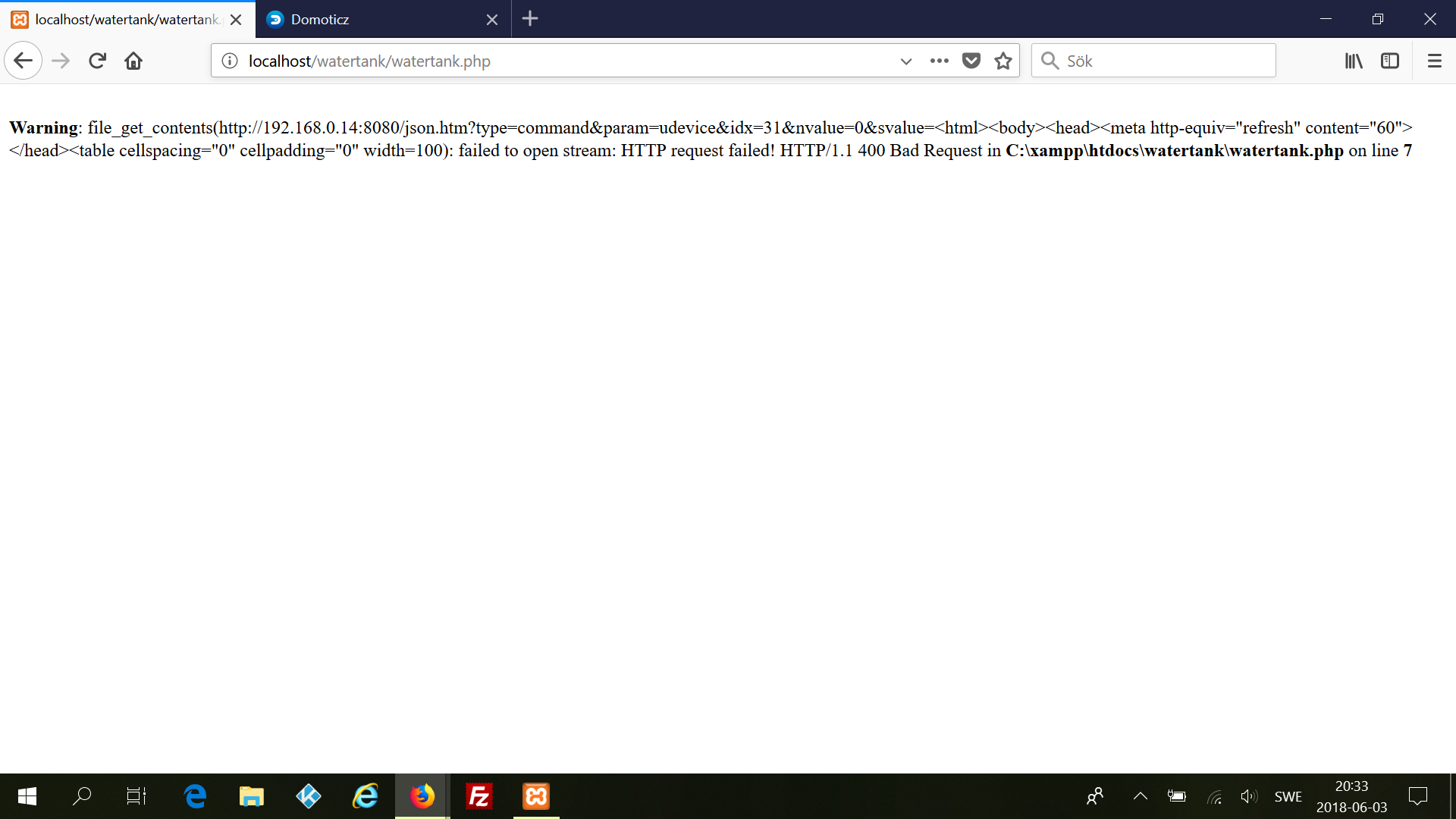

But i get the same error as if i use the correct ip adress?
i know it is reading because when tanklevel was offline i got error on line 2
- Screenshot (7).png (173.27 KiB) Viewed 4384 times

OMG, somewhere the 3th line got lost
<?php
$data=file_get_contents('http://192.168.0.12/tanklevl1');
$data=strafter($data,'</span><br>');
$data=strbefore($data,'%');
$idx=33;
$nvalue=0;
$svalue=$data;
file_get_contents('http://127.0.0.1:8080/json.htm?type=command¶m=udevice&idx='.$idx.'&nvalue='.$nvalue.'&svalue='.$svalue);
function strafter($string,$substring){
$pos=strpos($string,$substring);
if($pos===false)return $string;
else return(substr($string,$pos+strlen($substring)));
function strbefore($string,$substring){
else return(substr($string,0,$pos));
