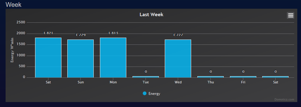

Taaaada!
I succeeded integrating Particle Photon (custom sensor) into Domoticz. On the Photon side I used TCPclient GET calls to post to Domoticz API. I had to resolve some quirks, but it is working good now. I am happy to post code if somebody would need it.
In Domoticz I have increment counter (virtual sensor) and I update it with Energy (U*I*time) every time pump stops pumping. This gives me nice overview, what is going on as f(t):
Weekly view
Weekly view

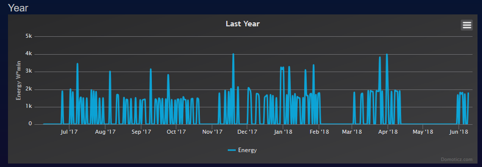

and I have also managed to inject 2.5 years of data in Domoticz.db and it plots it as its own:
Yearly view
Yearly view
Since pump runs normally once a day (if at all) trend can be easily observed. Whenever there is the spike approx. twice the height, this mean the pump run twice in that day. You can guess which months I was not at home ;)

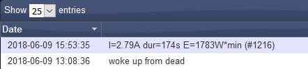

As bonus I figured out there is also very handy text sensor that takes whatever string as input and keeps very handy log.
Text sensor log
Text sensor log
Domoticz rulez!
