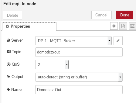

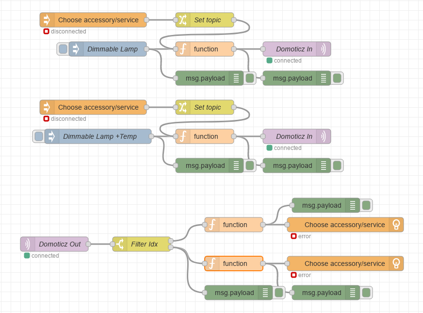

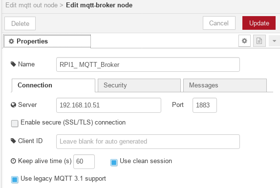

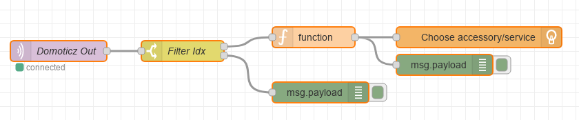

In the meantime I also have Node-Red running. I think I've got the connection to and from Domoticz via MQTT also already working.
I just have no idea how I get the MQTT messages from Casambi into Node-Red. Could you explain that to me?

You said:
You have to configure the "MQTT In" node as follows:
You can give the MQTT Server any name (in this case RPi1_MQTT_Broker), you like.
The Name for the node is free to choose. The topic in this case is domoticz/out.
Next step is to click on the pencil behind the name in order to configure the MQTT server in Node Red.
Insert the IP address of your MQTT server. If it is installed on the same machine, it is localhost or 127.0.0.1, otherwise its IP address.
Leave the port default 1883.
Click on "Update", "Done" and finally "Deploy" in the upper right corner.
If everything is okay, you will see "connected" and messages from Domoticz are displayed in the debug pane.
For the moment you can leave the other tabs default, unless you have secured your MQTT server with a username/password.

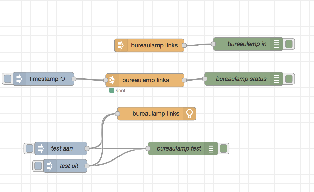

I have several nodes for input, output and status
When I toggle the light the input node gives me for example:
The thing I need to achieve is to take this data and change it to the right message so I can send it to the dummy light in Domoticz and vice versa. Hope you can help me with that.
Kind regards, Erik-Jan
or{"On":true,"Brightness":100}
Tunable white lights also give ColorTemperature variable:{"On":false,"Brightness":0};
When I trigger with a timestamp, the status node gives me for example:{"On":true,"Brightness":35,"ColorTemperature":440}
I can use the same msg.payload I receive to also toggle the lights from Node-Red{"On":true,"Brightness":35,"ColorTemperature":440}

I have already created a flow from Homebridge to Domoticz.
In the Inject node I have used the same string as you showed me. You can replace the Inject node for the Homebridge node and this should work.
Replace in the Function node the IDX (currently 22) for your IDX number of the created virtual Dimmer.
The other flow is intended for Domoticz to Homebridge
In the switch node you have to change the IDX's for the IDX of you created virtual switches.
If needed you can expand this node
Of course you have to configure the Homebridge nodes with the correct pin and device name.
Find the flow below and test it.

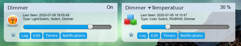

You're the best! Works like a charm!
There is one thing that does not work. When I switch a light off in Casambi, the light in Domoticz does not turn off. It only happens with off. Switching a light to on or change dim value works from Casambi to Domoticz. What could that be?
I also checked the maximum and minimum values for ColorTemperature. Maximum is 222 (4500K) and minimum is 454 (2200K).

As Domoticz uses from 0-255 I have stretched the range, if the data is going from Casambi to Domoticz a little and squeezed it, when it goes from Domoticz to Casambi.
You will find the complete flow below, but it is somewhat modified, compared with the previous one.
I will explain a little.
The top flow is for Casambi to Domoticz, only for dimmable lights, while the flow in the middle has the extra possibility for the color temperature.
There is no flow for color (RGB) lamps. If you need that, it has to be made.
The bottom flow is for Domoticz to Casambi
I made the flows somewhat universal.
As I understand you can connect only one device to the Homebridge node, called Choose accessory/service"
In the change node, called "Set topic" I have set the IDX number (in Domoticz) as topic.
So you can connect multiple "Dimmable lamp + Set topic" combinations to the Function node.
So you have to modify the change node and set your own Domoticz IDX.
Of course you might have to modify the MQTT nodes.
For the dimmable lamp = color temperature, it is exactly the same
For the flow, used from Domoticz, you have to set the IDX in the switch node, called "Filter Idx".
You can expand the switch node to, as many lamps as you have.
You have to copy the "Function" and "Homebridge" node, but be carefully that you copy the right combination for your lamp.
The top is for dimmable lights only, while the bottom has the color temperature option.
If it is to your satisfaction, you can remove all debug (green) nodes and the 2 inject (grey) nodes.
Below, you will find the flow.
Awaiting your test result.

Sometimes a program contains a bug and unfortunately, the flow I sent tooThere is one thing that does not work. When I switch a light off in Casambi, the light in Domoticz does not turn off. It only happens with off. Switching a light to on or change dim value works from Casambi to Domoticz. What could that be?
But it should be solved now. Test it.
This means that Casambi, via Homebridge, has a range from CoolWhite (222) to WarmWhite (454) of 232 steps.I also checked the maximum and minimum values for ColorTemperature. Maximum is 222 (4500K) and minimum is 454 (2200K).

Hi @FireWizard,
I only have it working for a short while, but it looks like it's working flawles.
Thanks again for your help! Otherwise I really couldn't have done it ...
