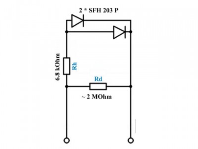

@Gerritjan
With LDR not measurement of UV-level, but 'semi'-measurement of lightlevel:
well-known configuration for better light-sensitivity is with 2 photodiodes at position of the LDR.
Photodiode-circuit
Photodiode-circuit
01 Schaltung Helligkeits-Sensor.jpg (10.74 KiB) Viewed 2345 times
E.g. BPW34 is practical alternative for the type of photodiode.
Plenty of descriptions available how to pack this circuit for best performance.
