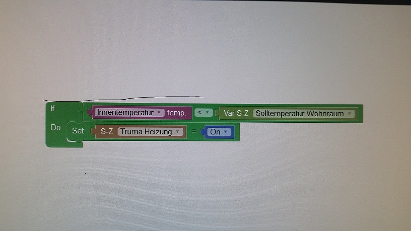

I have the following problem, I have written the blockly shown below but it does not work. It switches once when I change the variable but it does not automatically turn on. The internal temperature I have entered via a virtual dummy he is visible and displays correctly in Domoticz. does anyone know a solution?

I don't know much about Blockly but I think you are missing something to trigger that script. Maybe adding a time or a switch to the script may solve your problem.
E.g
if time is 9 AM and temp < 20 then turn on heating
or
if switch is On and temp < 20 then turn on heating

Thanks, I'll try that and get in touch

Did you change your Blockly Event type to UserVariable?
E.g
or
Thanks that was exactly the right idea !!!
it works perfect !!
Thank you so much EricT !!
