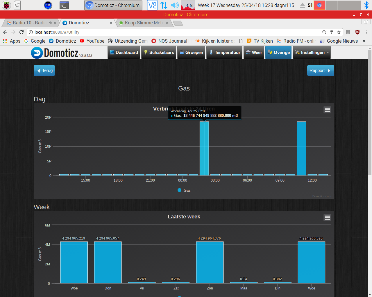

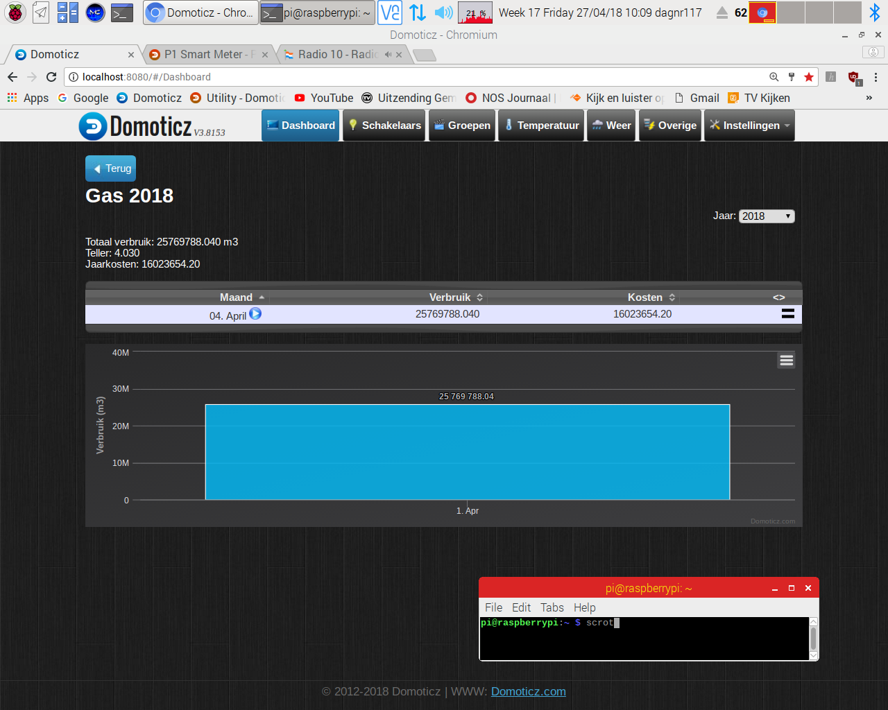

Hello
i have bought a raspberry pi 3b smartmeter kit from sossolutions https://www.sossolutions.nl/slimme-mete ... berry-pi3b
landis gyr e350 smr5
wireles gas meter connected to above (uniflo g4srt smr5 flonidan)
electric is working wel (exept that i am a bit dissapointed that the grapic day log is only a week long)
total gas use under button other devices is working wel 4.003m3 total used (i do not use much gas 4m3 in 14 days)
but the graphic log tells me i have days with 4milion m3 used or even much much more a value wich i can not pronounce
and also the weeklog is not correct
some data follows
am i the only one with this problem?
download/file.php?mode=view&id=15762
2018-04-24 16:00:00 0
2018-04-24 17:00:00 0
2018-04-24 18:00:00 0
2018-04-24 19:00:00 0
2018-04-24 20:00:00 0
2018-04-24 21:00:00 0
2018-04-24 22:00:00 0
2018-04-24 23:00:00 0
2018-04-25 00:00:00 0
2018-04-25 01:00:00 15744.284
2018-04-25 02:00:00 18446744949882880
2018-04-25 03:00:00 0
2018-04-25 04:00:00 0
2018-04-25 05:00:00 0.087
2018-04-25 06:00:00 0.077
2018-04-25 07:00:00 0
2018-04-25 08:00:00 0
2018-04-25 09:00:00 0
2018-04-25 10:00:00 0
2018-04-25 11:00:00 18446744949882880
2018-04-25 12:00:00 2.18
2018-04-25 13:00:00 0
2018-04-25 14:00:00 0
2018-04-25 15:00:00 0
2018-04-25 16:00:00 0
2018-04-18 00:00:00 4294965.219
2018-04-19 00:00:00 4294965.057
2018-04-20 00:00:00 0.249
2018-04-21 00:00:00 0.296
2018-04-22 00:00:00 4294964.376
2018-04-23 00:00:00 0.14
2018-04-24 00:00:00 0.382
2018-04-25 00:00:00 4294965.595

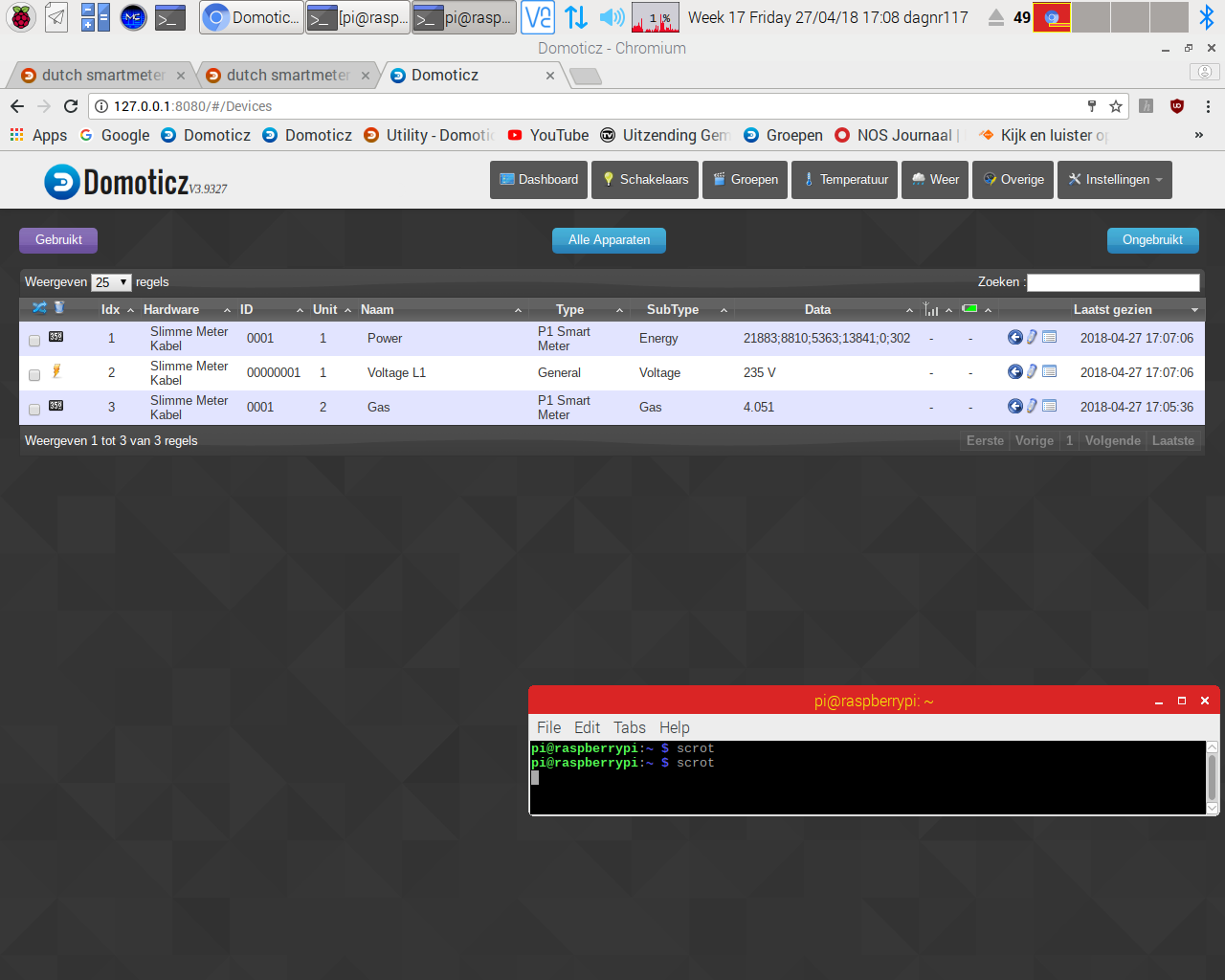

2018-04-27 08:06:18.130 P1 Smart Meter: Dismiss incoming - CRC failed
2018-04-27 08:06:20.124 P1 Smart Meter: Dismiss incoming - CRC failed
2018-04-27 08:06:21.130 P1 Smart Meter: Dismiss incoming - CRC failed
2018-04-27 08:06:22.119 P1 Smart Meter: Dismiss incoming - CRC failed
2018-04-27 08:06:23.123 P1 Smart Meter: Dismiss incoming - CRC failed
2018-04-27 08:06:24.130 P1 Smart Meter: Dismiss incoming - CRC failed
2018-04-27 08:06:26.123 P1 Smart Meter: Dismiss incoming - CRC failed
2018-04-27 08:06:27.130 P1 Smart Meter: Dismiss incoming - CRC failed
2018-04-27 08:06:28.119 P1 Smart Meter: Dismiss incoming - CRC failed
2018-04-27 08:06:29.124 P1 Smart Meter: Dismiss incoming - CRC failed
2018-04-27 08:06:30.131 P1 Smart Meter: Dismiss incoming - CRC failed
2018-04-27 08:06:31.789 P1 Smart Meter: Dismiss incoming - value in line "1-3:0.2.8(51-0:2.8.1(000004.900*kWh)" is oversized
2018-04-27 08:06:35.124 P1 Smart Meter: Dismiss incoming - CRC failed
2018-04-27 08:06:35.971 P1 Smart Meter: Dismiss incoming - value in line "1-0:32.7.0(233.0-1:96.1.0(4730303339303031383030323534303138)" is oversized
2018-04-27 08:06:37.772 P1 Smart Meter: Dismiss incoming - value in line "0-1:24.2.10-0:96.1.1(4530303435303034303134323932363137)" is oversized
2018-04-27 08:06:38.954 P1 Smart Meter: Dismiss incoming - value in line "1-0:32.7.0(2330-1:24.1.0(003)" is not a number
2018-04-27 08:06:44.122 P1 Smart Meter: Dismiss incoming - CRC failed
2018-04-27 08:06:45.124 P1 Smart Meter: Dismiss incoming - CRC failed
2018-04-27 08:06:46.125 P1 Smart Meter: Dismiss incoming - CRC failed
2018-04-27 08:06:48.122 P1 Smart Meter: Dismiss incoming - CRC failed
2018-04-27 08:06:49.124 P1 Smart Meter: Dismiss incoming - CRC failed
2018-04-27 08:06:49.940 P1 Smart Meter: Dismiss incoming - value in line "1-0:32.7.0(233.01-0:21.7.0(00.047*kW)" is oversized
2018-04-27 08:06:50.131 P1 Smart Meter: Dismiss incoming - CRC failed
2018-04-27 08:06:51.121 P1 Smart Meter: Dismiss incoming - CRC failed
2018-04-27 08:06:53.130 P1 Smart Meter: Dismiss incoming - CRC failed
2018-04-27 08:06:54.120 P1 Smart Meter: Dismiss incoming - CRC failed
2018-04-27 08:06:55.125 P1 Smart Meter: Dismiss incoming - CRC failed
2018-04-27 08:06:56.130 P1 Smart Meter: Dismiss incoming - CRC failed
2018-04-27 08:06:58.124 P1 Smart Meter: Dismiss incoming - CRC failed
2018-04-27 08:06:59.125 P1 Smart Meter: Dismiss incoming - CRC failed
2018-04-27 08:07:00.131 P1 Smart Meter: Dismiss incoming - CRC failed
2018-04-27 08:07:01.120 P1 Smart Meter: Dismiss incoming - CRC failed
2018-04-27 08:07:02.125 P1 Smart Meter: Dismiss incoming - CRC failed
2018-04-27 08:07:04.119 P1 Smart Meter: Dismiss incoming - CRC failed
2018-04-27 08:07:06.131 P1 Smart Meter: Dismiss incoming - CRC failed
2018-04-27 08:07:07.126 (Slimme Meter Kabel) P1 Smart Meter (Power)
2018-04-27 08:07:07.130 (Slimme Meter Kabel) General/Voltage (Voltage L1)
2018-04-27 08:07:07.137 (Slimme Meter Kabel) P1 Smart Meter (Gas)
2018-04-27 08:07:08.132 (Slimme Meter Kabel) P1 Smart Meter (Power)
2018-04-27 08:07:08.137 (Slimme Meter Kabel) General/Voltage (Voltage L1)
2018-04-27 08:07:10.121 P1 Smart Meter: Dismiss incoming - CRC failed
2018-04-27 08:07:10.745 P1 Smart Meter: Dismiss incoming - value in line "0-1:24.2.1(180-0:1.0.0(180427080709S)" is not a number
2018-04-27 08:07:12.976 P1 Smart Meter: Dismiss incoming - value in line "1-0:2.7.0(00.0-1:24.1.0(003)" is not a number
2018-04-27 08:07:15.133 P1 Smart Meter: Dismiss incoming - CRC failed
2018-04-27 08:07:17.126 P1 Smart Meter: Dismiss incoming - CRC failed
2018-04-27 08:07:18.131 P1 Smart Meter: Dismiss incoming - CRC failed
2018-04-27 08:07:21.132 P1 Smart Meter: Dismiss incoming - CRC failed
2018-04-27 08:07:23.126 P1 Smart Meter: Dismiss incoming - CRC failed
2018-04-27 08:07:24.123 (Slimme Meter Kabel) P1 Smart Meter (Power)
2018-04-27 08:07:24.127 (Slimme Meter Kabel) General/Voltage (Voltage L1)
2018-04-27 08:07:25.123 P1 Smart Meter: Dismiss incoming - CRC failed
2018-04-27 08:07:26.128 (Slimme Meter Kabel) P1 Smart Meter (Power)
2018-04-27 08:07:26.131 (Slimme Meter Kabel) General/Voltage (Voltage L1)
2018-04-27 08:07:27.131 P1 Smart Meter: Dismiss incoming - CRC failed
2018-04-27 08:07:29.126 P1 Smart Meter: Dismiss incoming - CRC failed
2018-04-27 08:07:31.120 P1 Smart Meter: Dismiss incoming - CRC failed
2018-04-27 08:07:33.131 P1 Smart Meter: Dismiss incoming - CRC failed
2018-04-27 08:07:35.125 P1 Smart Meter: Dismiss incoming - CRC failed
2018-04-27 08:07:39.127 P1 Smart Meter: Dismiss incoming - CRC failed
2018-04-27 08:07:40.132 P1 Smart Meter: Dismiss incoming - CRC failed
2018-04-27 08:07:41.121 P1 Smart Meter: Dismiss incoming - CRC failed
2018-04-27 08:07:43.127 P1 Smart Meter: Dismiss incoming - CRC failed
2018-04-27 08:07:45.124 P1 Smart Meter: Dismiss incoming - CRC failed
2018-04-27 08:07:45.775 P1 Smart Meter: Dismiss incoming - value in line "0-1:24.2.1(180427080503S)0-0:96.1.1(4530303435303034303134323932363137)" is oversized
2018-04-27 08:07:46.127 P1 Smart Meter: Dismiss incoming - CRC failed
2018-04-27 08:07:48.124 P1 Smart Meter: Dismiss incoming - CRC failed
2018-04-27 08:07:49.126 P1 Smart Meter: Dismiss incoming - CRC failed
2018-04-27 08:07:51.120 P1 Smart Meter: Dismiss incoming - CRC failed
2018-04-27 08:07:56.133 P1 Smart Meter: Dismiss incoming - CRC failed
2018-04-27 08:07:57.122 P1 Smart Meter: Dismiss incoming - CRC failed
2018-04-27 08:07:58.125 P1 Smart Meter: Dismiss incoming - CRC failed
2018-04-27 08:08:00.133 P1 Smart Meter: Dismiss incoming - CRC failed
2018-04-27 08:08:02.125 P1 Smart Meter: Dismiss incoming - CRC failed
2018-04-27 08:08:04.133 P1 Smart Meter: Dismiss incoming - CRC failed
2018-04-27 08:08:07.132 P1 Smart Meter: Dismiss incoming - CRC failed
2018-04-27 08:08:08.120 P1 Smart Meter: Dismiss incoming - CRC failed
2018-04-27 08:08:09.125 P1 Smart Meter: Dismiss incoming - CRC failed
2018-04-27 08:08:10.883 P1 Smart Meter: Dismiss incoming - value is not delimited in line "1-0:2.7.0(00.00"
2018-04-27 08:08:12.125 P1 Smart Meter: Dismiss incoming - value is not delimited in line "1-3:0.2.8(50!6045"
2018-04-27 08:08:14.121 P1 Smart Meter: Dismiss incoming - CRC failed
2018-04-27 08:08:15.127 P1 Smart Meter: Dismiss incoming - CRC failed
2018-04-27 08:08:17.121 P1 Smart Meter: Dismiss incoming - CRC failed
2018-04-27 08:08:18.125 P1 Smart Meter: Dismiss incoming - CRC failed
2018-04-27 08:08:20.121 P1 Smart Meter: Dismiss incoming - CRC failed
2018-04-27 08:08:21.127 P1 Smart Meter: Dismiss incoming - CRC failed
2018-04-27 08:08:22.133 P1 Smart Meter: Dismiss incoming - CRC failed
2018-04-27 08:08:23.121 P1 Smart Meter: Dismiss incoming - CRC failed
2018-04-27 08:08:24.128 P1 Smart Meter: Dismiss incoming - CRC failed
2018-04-27 08:08:27.126 P1 Smart Meter: Dismiss incoming - CRC failed
2018-04-27 08:08:28.852 P1 Smart Meter: Dismiss incoming - value in line "1-0:2.7.0(000-0:96.7.9(00000)" is not a number
2018-04-27 08:08:29.121 P1 Smart Meter: Dismiss incoming - CRC failed
2018-04-27 08:08:31.900 P1 Smart Meter: Dismiss incoming - value in line "1-0:2.8.2(0001-0:32.36.0(00000)" is oversized
2018-04-27 08:08:32.123 P1 Smart Meter: Dismiss incoming - CRC failed
2018-04-27 08:08:34.133 P1 Smart Meter: Dismiss incoming - CRC failed
2018-04-27 08:08:35.123 P1 Smart Meter: Dismiss incoming - CRC failed
2018-04-27 08:08:36.126 P1 Smart Meter: Dismiss incoming - CRC failed
2018-04-27 08:08:37.133 (smartone) P1 Smart Meter (Power)
2018-04-27 08:08:37.134 (smartone) General/Voltage (Voltage L1)
2018-04-27 08:08:38.123 P1 Smart Meter: Dismiss incoming - CRC failed
2018-04-27 08:08:40.134 P1 Smart Meter: Dismiss incoming - CRC failed
2018-04-27 08:08:41.123 P1 Smart Meter: Dismiss incoming - CRC failed
2018-04-27 08:08:42.127 P1 Smart Meter: Dismiss incoming - CRC failed
2018-04-27 08:08:43.139 (Slimme Meter Kabel) P1 Smart Meter (Power)
2018-04-27 08:08:43.143 (Slimme Meter Kabel) General/Voltage (Voltage L1)
2018-04-27 08:08:44.122 P1 Smart Meter: Dismiss incoming - CRC failed
2018-04-27 08:08:45.973 P1 Smart Meter: Dismiss incoming - value in line "1-0:32.7.00-1:96.1.0(4730303339303031383030323534303138)" is oversized
2018-04-27 08:08:48.128 P1 Smart Meter: Dismiss incoming - CRC failed
2018-04-27 08:08:49.134 P1 Smart Meter: Dismiss incoming - CRC failed
2018-04-27 08:08:50.123 P1 Smart Meter: Dismiss incoming - CRC failed

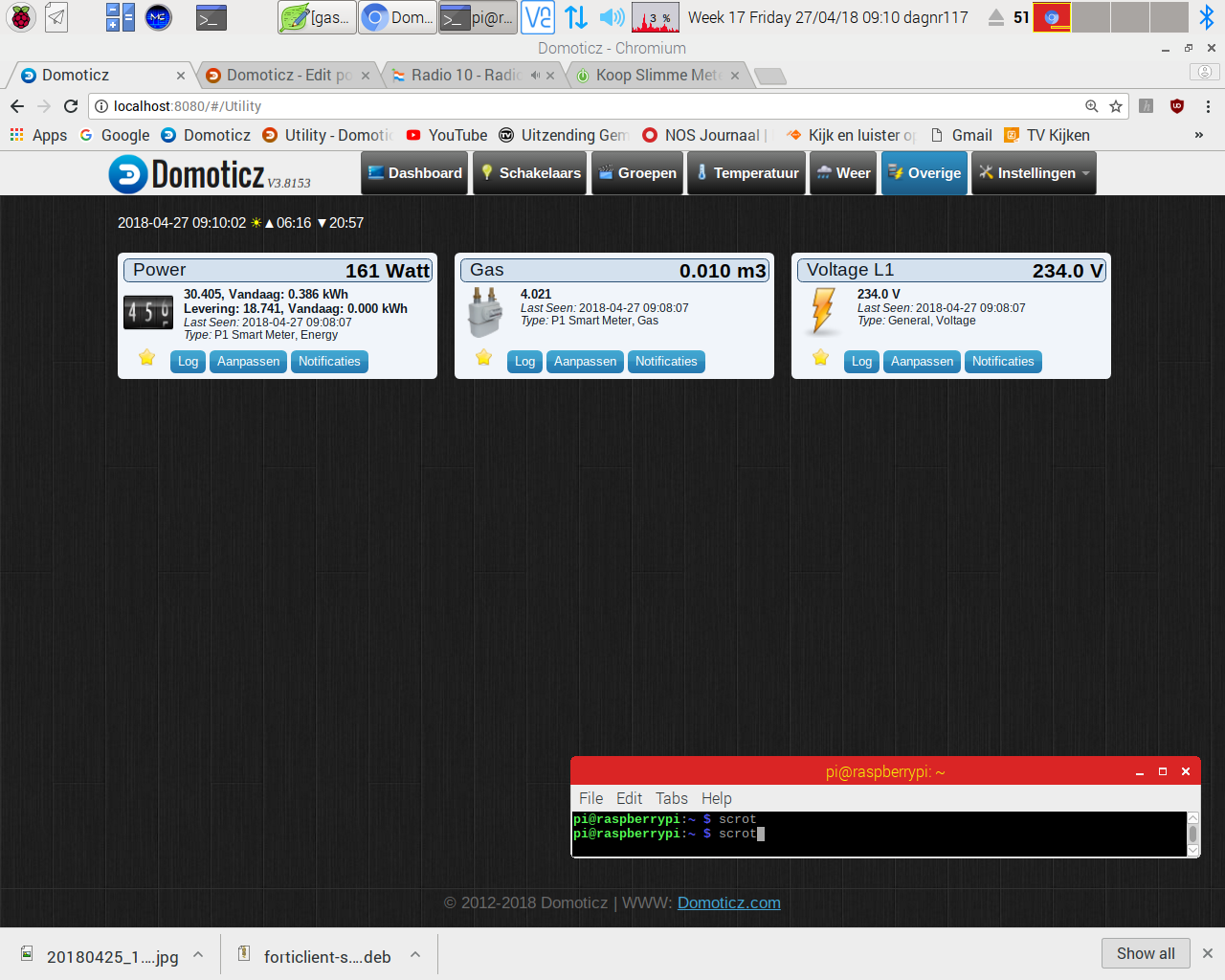

2018-04-27 11:40:49.670 Domoticz V3.8153 (c)2012-2017 GizMoCuz
2018-04-27 11:40:49.670 Build Hash: 494fff7, Date: 2017-07-30 12:19:41
2018-04-27 11:40:49.670 Startup Path: /home/pi/domoticz/
2018-04-27 11:40:49.867 EventSystem: reset all events...
2018-04-27 11:40:50.125 PluginSystem: Started, Python version '3.5.3'.
2018-04-27 11:40:50.141 WebServer(HTTP) started on address: :: with port 8080
2018-04-27 11:40:50.153 WebServer(SSL) started on address: :: with port 443
2018-04-27 11:40:50.154 Proxymanager started.
2018-04-27 11:40:50.195 TCPServer: shared server started...

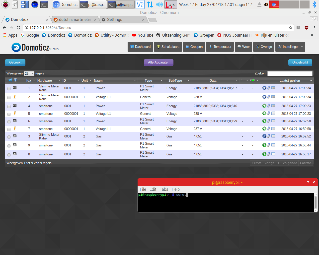

Hmmm.... Do you have two smart meters setup? I'm seeing `smartone` and `Slimme Meter Kabel`.
- luberth
- Posts: 34
- Joined: Friday 27 April 2018 7:56
- Domoticz version: 4.9700
- Location: Bangert 30 Andijk Nederland
Re: dutch smartmeter gas usage 4.294.965m3 a day
i have selected the green ones and used the trash icon left above
but the not used green ones come back
are never gone
again checked the checkbox of the green unused ones
pressed the trashcan icon popup realy yes popup removed
but when i go away and comeback the green unused ones are back again
ok i now removed 2 lines from hardware section
i am so stupid
now no errors

so problem whas multiple p1 meters in hardware
in settings devices they where unused
but unused is not unused i think
2018-04-27 17:18:37.546 P1 Smart Meter: Serial Worker stopped...
2018-04-27 17:18:43.749 P1 Smart Meter: Serial Worker stopped...
2 unused serial workers made the crc and other faults?
hope my mistakes will help others

gordonb3
- Posts: 111
- Joined: Saturday 31 March 2018 22:24
- Domoticz version: Custom
- Location: Delft, NL
Re: dutch smartmeter gas usage 4.294.965m3 a day (problem solved)
If you have multiple entries in Domoticz listening to the same hardware device, then my guess is that it becomes unpredictable which message part ends up with either instance. As such it appears you've been fragmenting the data from the hardware between those instances and as a result none of them got the complete message. Did you have the additional hardware disabled or only have the corresponding devices set as unused?
i did only have the corresponding devices set as unused
electric graphic day log is also much smoother line now
but have to figure out now how to remove the milions of m3 gas that are in the data
thanks for your help!

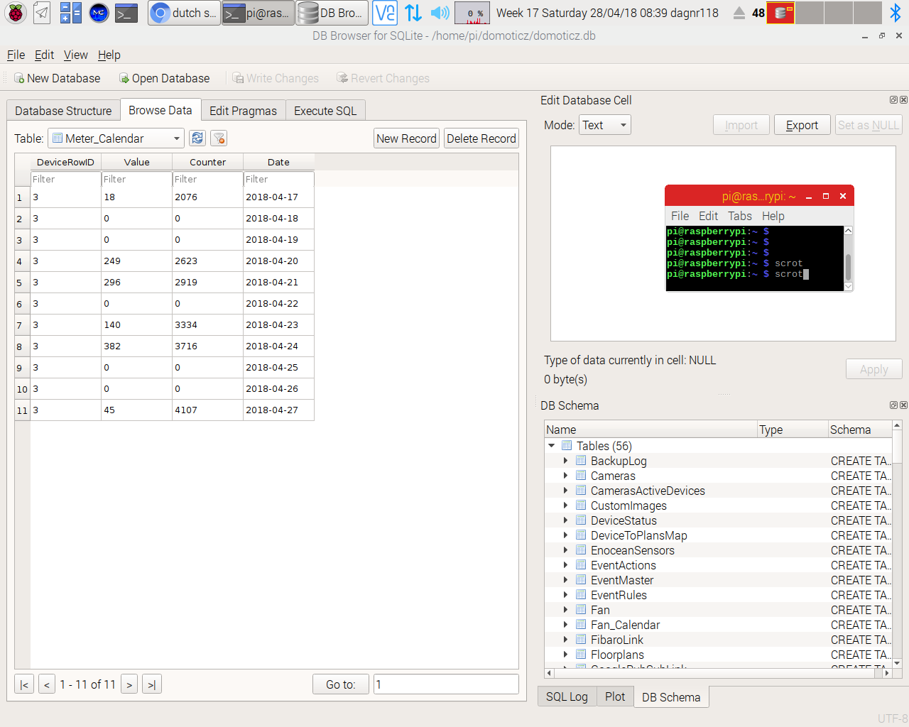

pi@raspberrypi:~ $ sudo apt-get update
pi@raspberrypi:~ $ sudo apt-get install sqlitebrowser
now an db browser for sql lite in raspbian accesiores menu
edit domoticz.db
open /home/pi/domoticz/domoticz.db
found some 4milion valeus under meter _calendar changed them to 0
ok milion valeus are out of domoticz log view
edit domoticz.db
