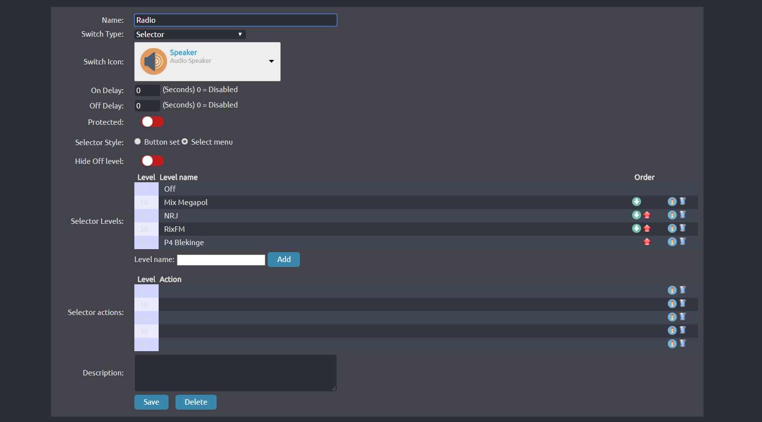

Make a new selector switch with your favorite name, e.g "Radio". Add your radio stations name in "Selector Levels". Then add a new dzVents script. Copy the code and change the radio station addresses, the switch name and the switch selector names. That's about it.
