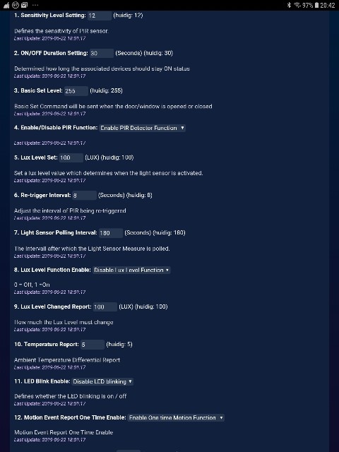

Post by tonbor »
Fine for you poudenes that you has nothing to change. We are not so lucky. Neo Cam changes the features of its objects without changing the type and id number. So you get stuck as you wandering why parameters will not change. I got a manual where disable blinking is at index 11 not 10 as in the xml. So if disable blinking can not be set, we go searching for another XML where blinking is definded at index 11. With a battery powered device which is mostly asleep it is difficult to trace what is going wrong...… any suggestions? What are your id and library where you have nothing to change?

tonbor
Posts: 156
Joined: Monday 17 February 2014 9:12
Re: neo coolcam motion sensor with temp sensor, unknown in domoticz
Post by tonbor »
More Help Text.jpg (325.8 KiB) Viewed 3872 times
Same xml but more help text.
