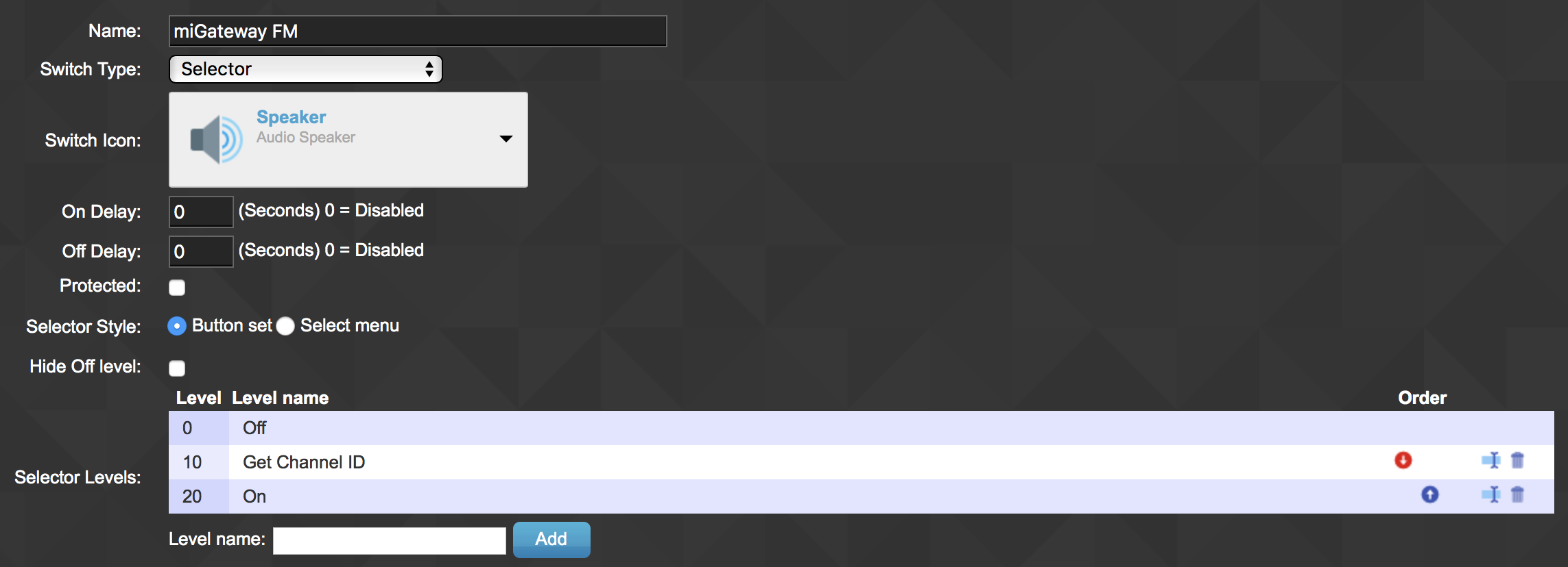

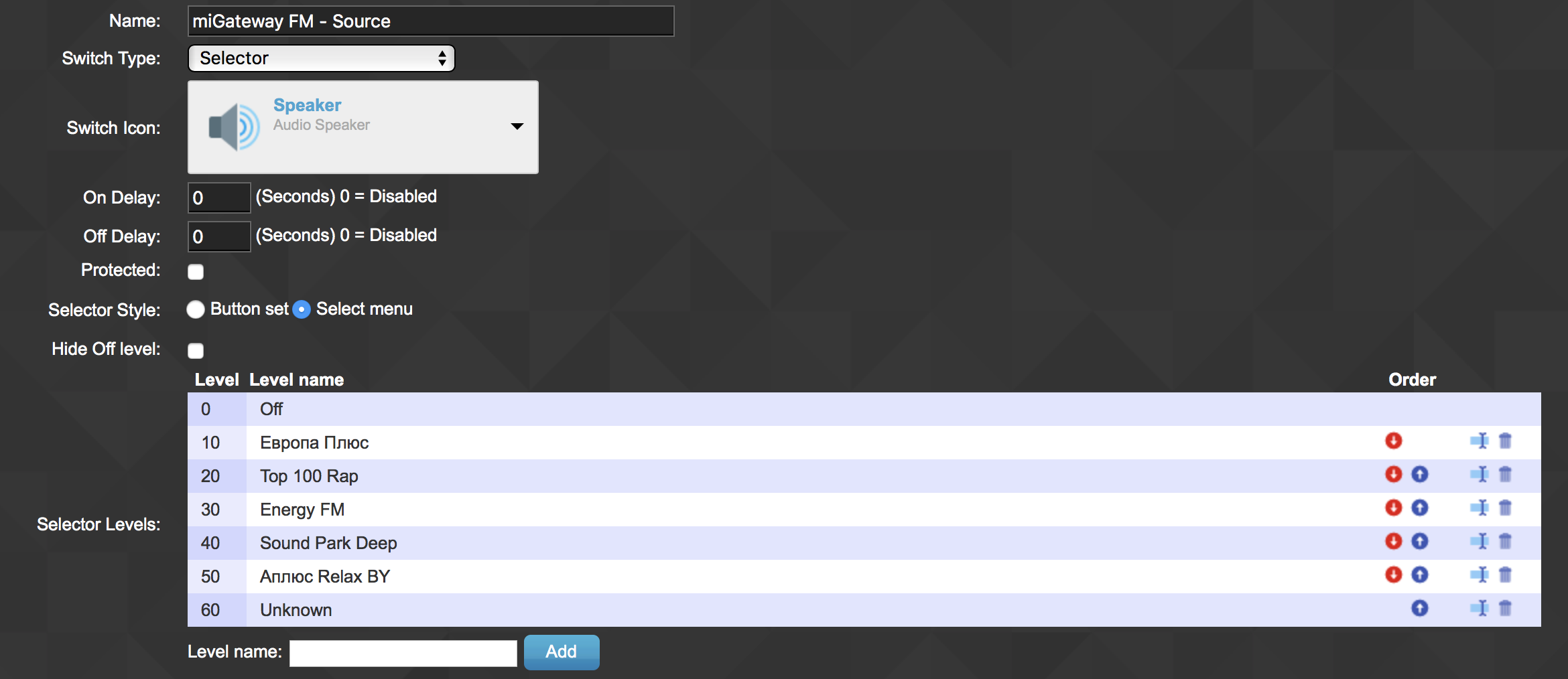

  • Create two dummy switches miGateway FM and miGateway FM - Source - type: Selector Switch with levels.

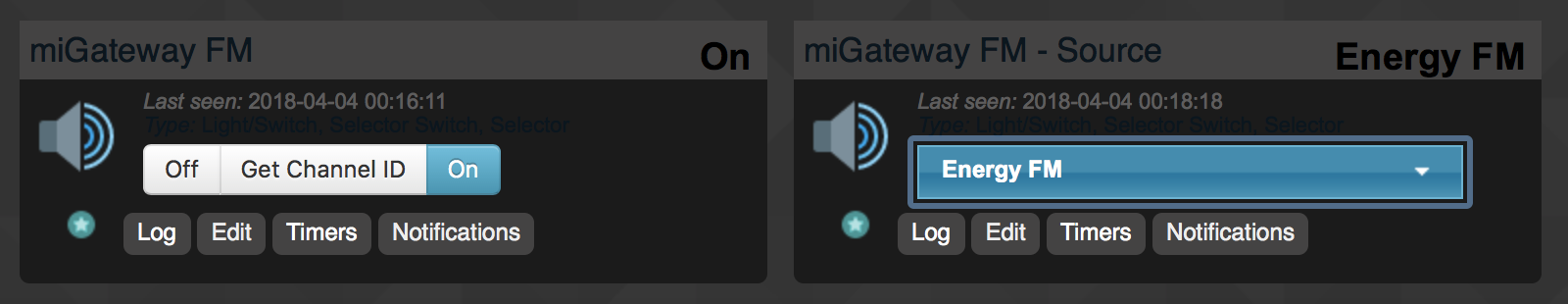

  • Play a favorite channel in the MiHome app. In the Domoticz GUI click on the Get Channel ID on the miGateway FM switch. The ID of the channel will be shown in the log.
    2018-04-04 12:06:07.502 User: Admin initiated a switch command (86/miGateway FM/Set Level)
    2018-04-04 12:06:07.511 (Dummy) Light/Switch (miGateway FM)
    2018-04-04 12:06:08.135 dzVents: Channel ID = 527782027
  • Copy, paste it and the channel name into the script. Make for all the necessary channels. In the example 5 channels.

  • Edit the switch miGateway FM - Source. Change the levels names to your own. The Unknown level is required!

  • Listen your favorite radio stations from Domoticz
