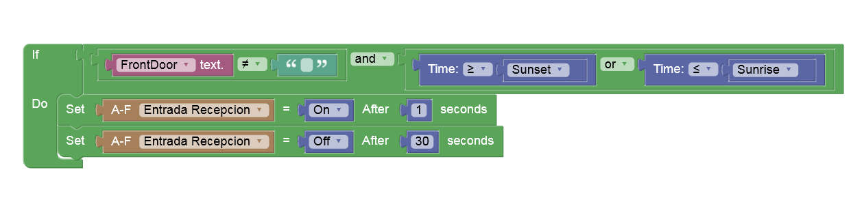

Came across this when looking for a solution. The answer is ...maybe. :) The following may help someone.
I had exactly the same issue with a text sensor. Even though the values reported were correct, couldn't get a script to run based on them.
But found that Blockly would respond to a change in value, so that was used instead. That was good enough in this case, which just switches on a door "Courtesy Light" for a short period at night.
Another oddity - it wouldn't run if an "If/ElseIf" block was used to set additional conditions.
Maybe the result could be used to trigger yet another script, but that seems to be a clumsy way to go.
