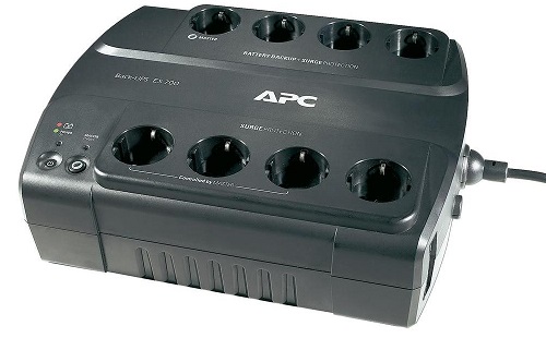

Today I installed a APC Back-UPS ES Power-Saving 700VA 230V, BE700G-GR to my Synology DS413.
It's possible to enable UPS server on the Synology and use it on the Raspberry. If you connect the Raspberry's powersupply to the UPS, you can safely shut down the system when the battery is almost empty.
On the raspberry you need to install NUT
sudo apt-get install nut
edit the monitoring config
sudo nano /etc/nut/upsmon.conf
Scroll down to the part MONITOR
# MONITOR [email protected] 1 upsmon secretpass slave
# MONITOR myups@localhost 1 upsmon pass master  (or slave)
and add below:
MONITOR [email protected] 1 monuser secret slave
Change the IP to the IP of your NAS. All the other info suitable for every Synology NAS
Save the file and quit nano
Edit nut configuration
sudo nano /etc/nut/nut.conf
Change MODE=none into
MODE=netclient
Start monitoring the remote UPS server
sudo /etc/init.d/nut-client start
With the default settings the Raspberry will check the UPS status every 5 seconds. If it detects that the UPS is running on battery (when main power has failed), it will continue to monitor. If the connection is lost after that (NAS powered down) it will monitor for another 15 seconds before the Raspberry will shut down.
I have my Synology DS413, Raspberry and DSL router connected to the APC. It should keep everything running for al least 15 minutes when the power is down. :mrgreen:
