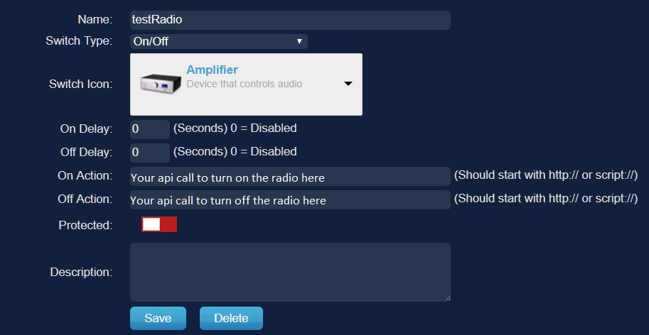

Now: I also have "devices" on my own, like an internet radio based on a RPi I built. It has today an API I can query to switch it on and off. I could change my code to instead use MQTT (the radio would subscribe to a topic and run from there). I would probably like to connect it to domoticz so that I can run some scenarios (say - a light sensor senses that the sun is up and switches the radio, something I believe I can program via the LUA scripting built into domoticz).
Should I look at setting it us as a switch (possibly with a nicer icon) or is there a special way to add such new devices?
Re: How to link a script to a device?
Posted: Monday 12 March 2018 21:32
by waaren
I am by no means a specialist on this but in the case you describe I would define the radio in domoticz as a virtual device with the current API calls in the "on action" and "off action" fields of the device.
