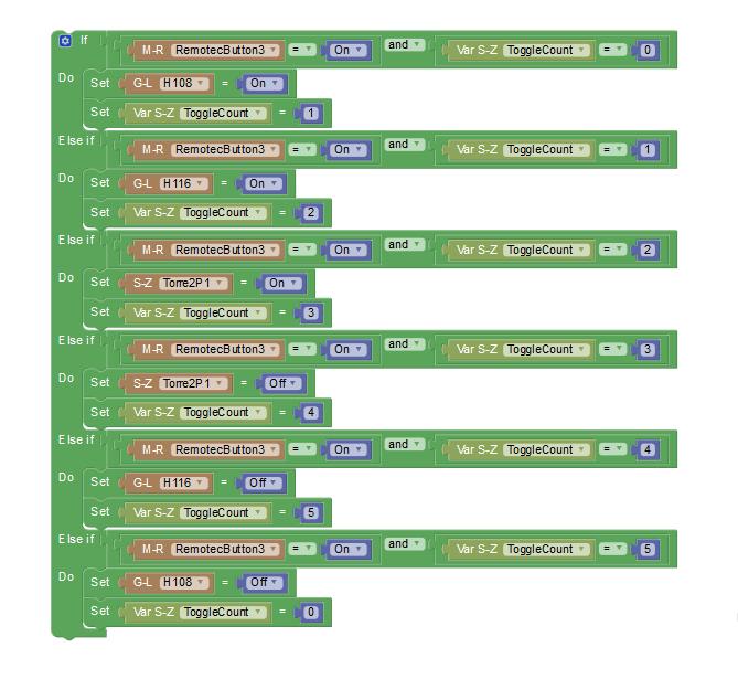

Another variation on the same theme. This allows a single button on a Remotec ZRC-90 to successively toggle 3 switches on and then back off again in reverse order.
2018-04-07 14_25_16-Domoticz.jpg (56.37 KiB) Viewed 8319 times

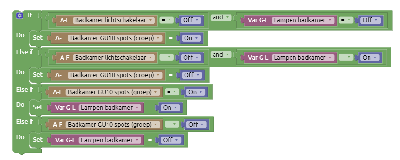

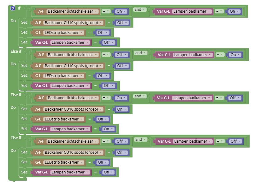

I tried different options to create a toggle switch from a wall switch using Blocky. Also tried the method mentioned in the wiki. The light keeps going on and of every 8 or so minutes. I tried these 2 options, both of them have this slow loop:
Toggle 1.png (48.11 KiB) Viewed 3872 times
Toggle 2.png (87.8 KiB) Viewed 3872 times
I set trigger to "Device". I checked wether the switch is reporting/messaging every 8 minutes or things like that: log of the switch only shows if I switch it myself. The Switch is a Shelly 1, I can set it to momentary switch or on/off switch.
Hope someone can help with this.
