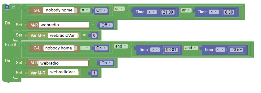

I have tricky situation, atleast for me :)
I have event which set swich nobody home on or off when anyone of my family members phones is on wifi. that works quite well.
And I have made event which set netradio On or Off when someone is home depending time (off at night).
First it pi had volumio but then internet radio started to cutoff and and I thought it was bad wifi signal or volumio newest update. I changed to pimusicbox but even worse.
Well now I noticed that problem is this event, it just switches on and off webradio switch on domoticz frequently and thats why it "raps" my webradio.
How should I do this ?

Should the or not be and in the first line between the times ?

Ups. I made rule again so it was default. I will test later.

I didnt get it right, but I found this lua script what I did coverted to match my situation
https://www.domoticz.com/wiki/Smart_Lua_Scripts -> "Simple event to switch on devices based on status of other devices & time"
there was error code:
" Router'] == 'On' t$" what should be "Router'] == 'On' then"

ok found my problem, I did made new script for ubiquiti controller on my debian server and I forgot another precesense script on. so user error :)
those "or"s are ok and use to be, so if nobody isnt home or at night (at 21 till 8) webradio shuts off.
