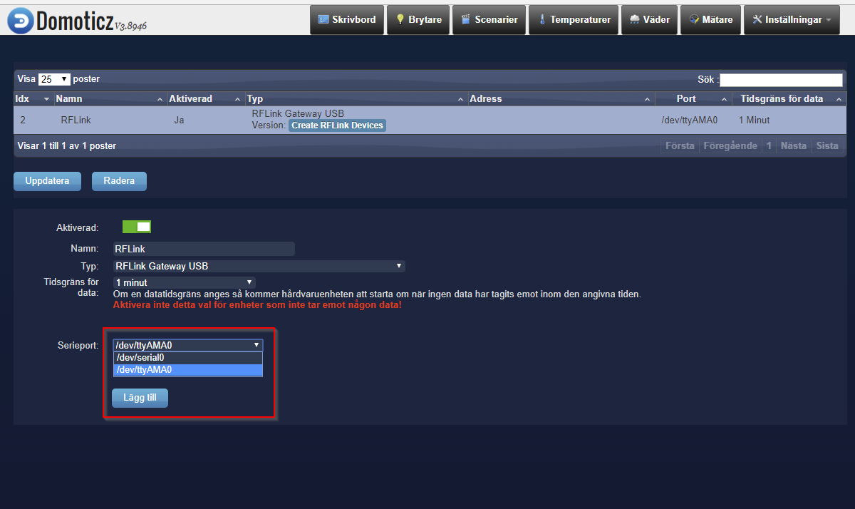

Under hardware the port was empty. Shouldn't it be named something like /dev/ttyUSB? See picture.

Your system needs reinstall... Or better voltage

It was the USB cable that was the problem. Now it works again. Thanks for the help.
