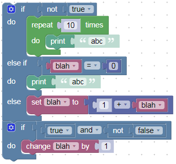

What i see from testing the logic blocks on blockly demo site they produce real else if and such.
Produces this lua code:
so it's the implementation of blockly in domoticz that's weird.
if not true then
for count = 1, 10 do
print('abc')
elseif blah == 0 then
print('abc')
blah = 1 + blah
if true and not false then
blah = blah + 1
end-

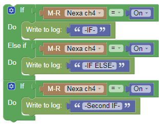

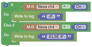

If setting up an -if-else- block. its intepreted as 2 -if- blocks after eachother. its not an else condition.
both -if- and - if-else- are ran independent ignoring if it matches the if condition.
This example should never reach the else if. if the first is tru the second should not run and when pushing the button. both rows are executed as expected with 2 separate ifs
so its converted to something like:
enabling -ELSE- (only else) in the if-else block would also be freaking super.
2018-02-23 08:53:10.091 EventSystem: Event triggered: elseiftest_1
2018-02-23 08:53:10.091 -IF-
2018-02-23 08:53:10.091 EventSystem: Event triggered: elseiftest_2
2018-02-23 08:53:10.091 -ELSE IF-
if nexach3 = on
print('-IF-')
if nexach3 = on
print('-ELSE IF-')
