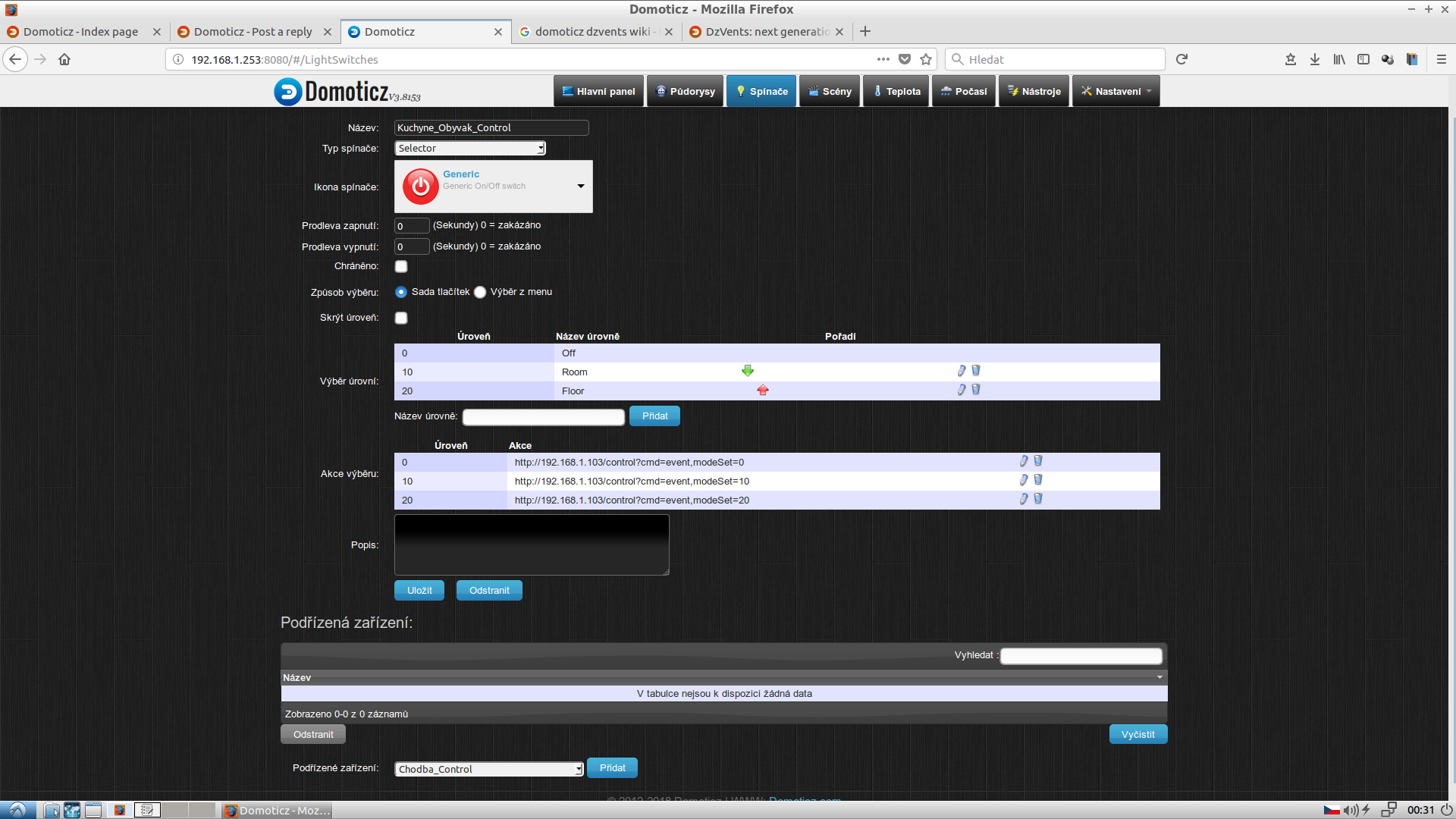

Here is my way, how I send selector value ( 0, 10, 20,... ) to ESPEasy.
For inspiration part of code my "every minute" script, which send state of selector to ESPeasy every minute.
I think
".level" is what you looking for.
In my case I am sending:
http://192.168.1.105/control?cmd=event,modeSet=0
or
http://192.168.1.105/control?cmd=event,modeSet=10
or
http://192.168.1.105/control?cmd=event,modeSet=20
according selector state.
https://www.domoticz.com/wiki/DzVents:_ ... or_etc..29
local mode = domoticz.devices('Filip_Control')
local url2= 'http://192.168.1.105/control?cmd=event,modeSet='..(mode.level)..''
print(url2)
domoticz.openURL(url2)".level" is what you looking for.
or
or
