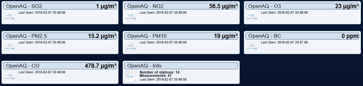

You want to monitor the air quality at your location?
This plugin uses the api provided by OpenAQ to retrieve data about the current air quality. It uses the location as specified in Domoticz. The plugin is available at:
