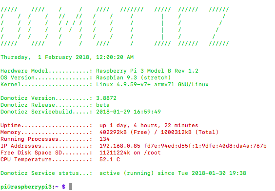

For who is interested: Edit the file
/home/pi/.bashrc and put at the end the following code:
echo "$(tput setaf 2)
`date +"%A, %e %B %Y, %r"`
Hardware Model............: `(tr -d '\0' </proc/device-tree/model)`
OS Version................: `/usr/bin/lsb_release -s -d | grep Raspbian | awk {'print $1,$3,$4'}`
Kernel....................: `uname -srmo`
Domoticz Version..........: `curl -s -X GET "http://127.0.0.1:8088/json.htm?type=command¶m=getversion" | /bin/grep -v dzvents | /bin/grep "version" | awk {'print $3'} | /usr/bin/cut -d '"' -f 2 | /usr/bin/cut -d '"' -f 1`
Domoticz Release..........: `curl -s -X GET "http://127.0.0.1:8088/json.htm?type=command¶m=getversion" |grep -Po '(?<=channel=)[^&]*'`
Domoticz Servicebuild.....: `curl -s -X GET "http://127.0.0.1:8088/json.htm?type=command¶m=getversion" | /bin/grep "build_time" | awk {'print $3,$4'} | /usr/bin/cut -d '"' -f 2 | /usr/bin/cut -d '"' -f 1`
$(tput setaf 1)
Uptime....................: `exec -- uptime -p`
Memory....................: `cat /proc/meminfo | grep MemFree | awk {'print $2'}`kB (Free) / `cat /proc/meminfo | grep MemTotal | awk {'print $2'}`kB (Total)
Running Processes.........: `ps ax | wc -l | tr -d " "`
IP Addresses..............: `sudo hostname -I`
Free Disk Space SD........: `df -Pk | grep -E '/root' | awk '{ print $4 }' | awk -F '.' '{ print $1 }'`k on /root
CPU Temperature...........: `exec -- /opt/vc/bin/vcgencmd measure_temp | cut -c "6-9"` C
$(tput setaf 2)
Domoticz Service status...: `sudo service domoticz status | grep Active | cut -c "11-54"`
The result:
