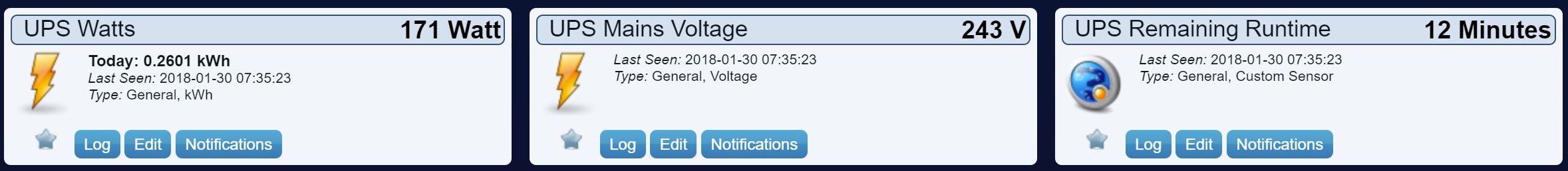

This is a bash script to get data from a CyberPower RMCARD205 network card via SNMP and load it into Domoticz.

Example output from the script:
root@domoticz:~/scripts/ups# ./ups.sh
UPS Model: OR600ELCDRM1U
Power Rating: 600 va or 360 watts
Status: Running on AC
Input Voltage: 243
Output Voltage: 243
Battery Capacity %: 100
Remaining Runtime Minutes: 12
Battery Replacement: Not needed
Load %: 57
Estimated load in watts: 171
Last self test result: OK
Last self test date: 01/30/2018
