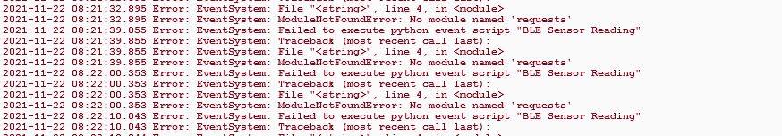

Only just got back to looking at this, I still have this error:-
requests error.jpg (53.51 KiB) Viewed 2436 times
However when I try to install the "requests" module I am told the requirement is already satisfied for both python2 and 3.
Any ideas guys ?

Posted: Thursday 10 February 2022 12:02
by Dave21w
Still can't get this to work despite installing what believe are all rerquirements
Anybody else have any success ?
Re: Xiaomi BLE temperature & humidity sensor
Posted: Thursday 10 February 2022 15:31
by waltervl
libraries have to be installed with the same user as the user running Domoticz else it cannot find it.
So if root is running Domoticz use 'sudo pip3' to install the libraries. else install with normal pip3
