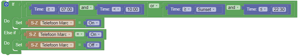

I created a blocky script to sitch on/off light in the morning and the evening. But it is switched on and a few seconds later off. During the period it should be on. I am sure I miss something but I am just a beginner so maybe someone can help me.

Blocky diagram is also attached:
Blocky Morning-Evening.jpg (105.34 KiB) Viewed 2601 times

So in a timeframe you are switching "Telefoon Marc" to On, and in the Else If you are switching it Off when it is On.
Because it's a timed blocky this happens every minute.
The blocky works as it should :-)

I thought I could achieve the switch off out side the time window with the "else if" if it is not in the time window there is an else and this is switch off. If it is in the time window I thought it would not use the "else if" or am I wrong?

Split it in two blocky events. That would work.

The else statment isn't working as expected or is not working at all.
So your understanding of programming is ok, but the blocky is s***t :-)
Lets start with the first step.
Why do you switch on the phone every minute between 07:00 and 10:00?
You could switch on at 07:00 single shot correct?
For the second step. only switch on after sunset but only till 22:30 ?
But still doing this every min.
Start splitting in two scripts as a first step.
Still this is much easier doing it in timers :-) sorry..
