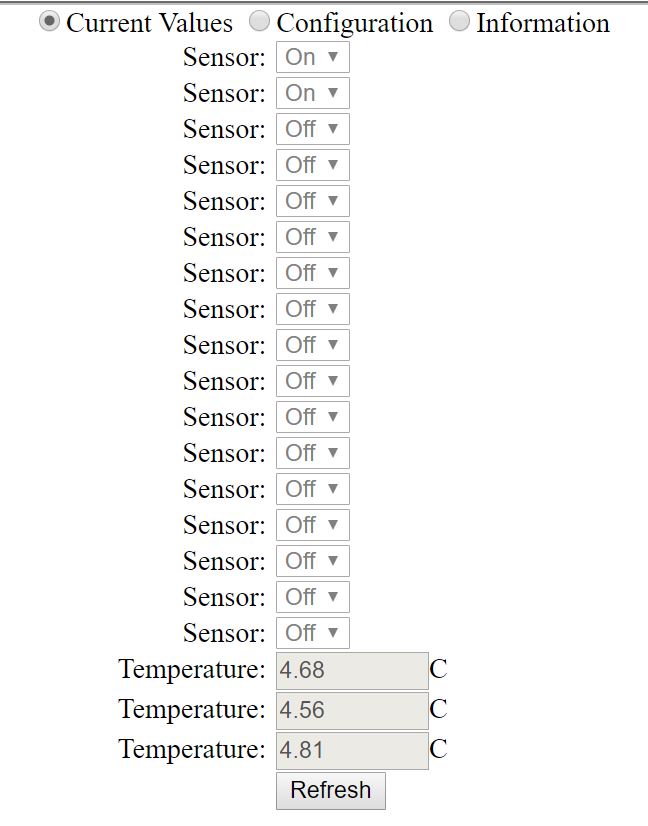

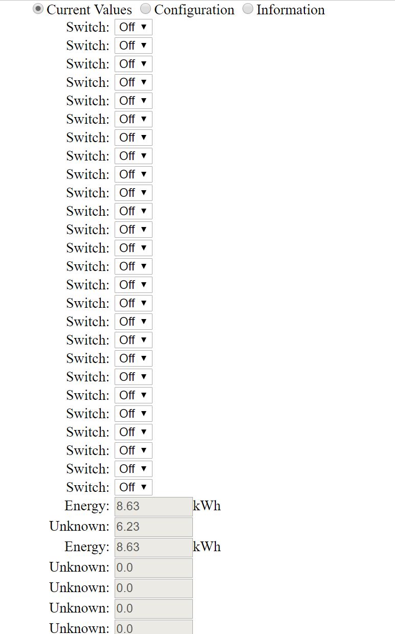

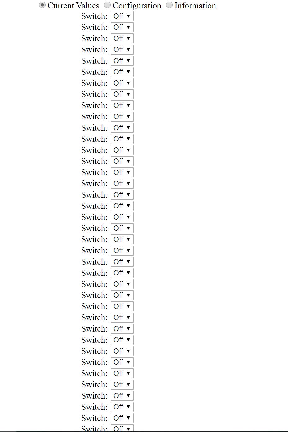

Some of my zwave devices have lots of additional switches, above and beyond what is really there.
Examples below:
- Fibaro Universal Sensor - 17 additional sensors
- Pan04 - 27 Switches
- Quibino Flush 2 relay - 40+ switches!
When initially paired they all had the correct amount, but this number seems to creep up over time.
Q1 - Does anyone else see this?
Q2 - If so is there any reason why? I could understand if it was signal to one device/manufacturer, but it seems to be over multiple
Q3 - Is there a way for me to tidy this up without having to repair?
