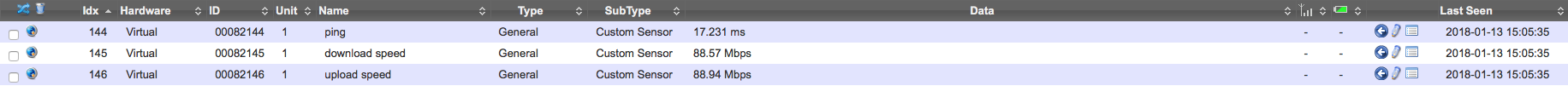

(1) If you look at Setup > Hardware, do you have a dummy entry that looks like this (possibly with a different idx): If you don't have this, pls post a screen shot of your hardware interfaces.
(2) If you look at Setup > Devices (and search on "Custom"), do you have custom sensors that looks like this (likely with a different idx, each of these virtual sensors was made by pressing the "Create Virtual Sensor" button for the Dummy interface in Hardware and setting the Sensor Type to Custom Sensor): If you don't have this, pls post a screen shot of your devices, limited by a search on "Sensor". Also, it would help if you can show us the lines for the devices with idx 57, 98 and 99 (the ones you have configured in your script).
I don't understand why you get the script error in the Domoticz log if you are using cron, or have you also made the "broadband switch" to execute the script? (I've never tried that part, but I'll add one to see how this works). One common issue with running scripts from with Domoticz are permissions. I would consider a `chmod 755 /home/pi/domotics/speedtest.sh` (or alternatively `chmod a+rx /home/pi/domotics/speedtest.sh`) so that all users can read and execute the script.
[update]
The "Error executing script command"-error can be solved by adding the line "exit 0" to the end of your script. Without that line an exit code different than 0 is returned, which is interpreted by Domoticz as an error.
cheers,
Leon
The fact that you do not see the sensors (even with a value of 0) in the Utility tab makes me think something may have gone wrong with the virtual sensor setup. Let's check your configuration:pascalbianca wrote: Saturday 13 January 2018 14:29 - [...] I don't see sensors in the utility menu
-Yes the virtual sensors for ping, downstream and upstream did i make in Domoticz [...]
[update]
cheers,
Leon
