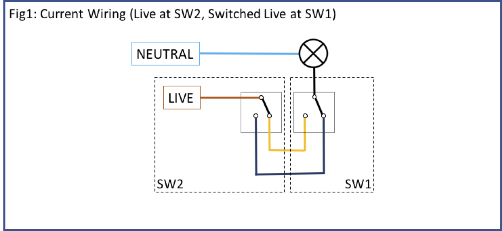

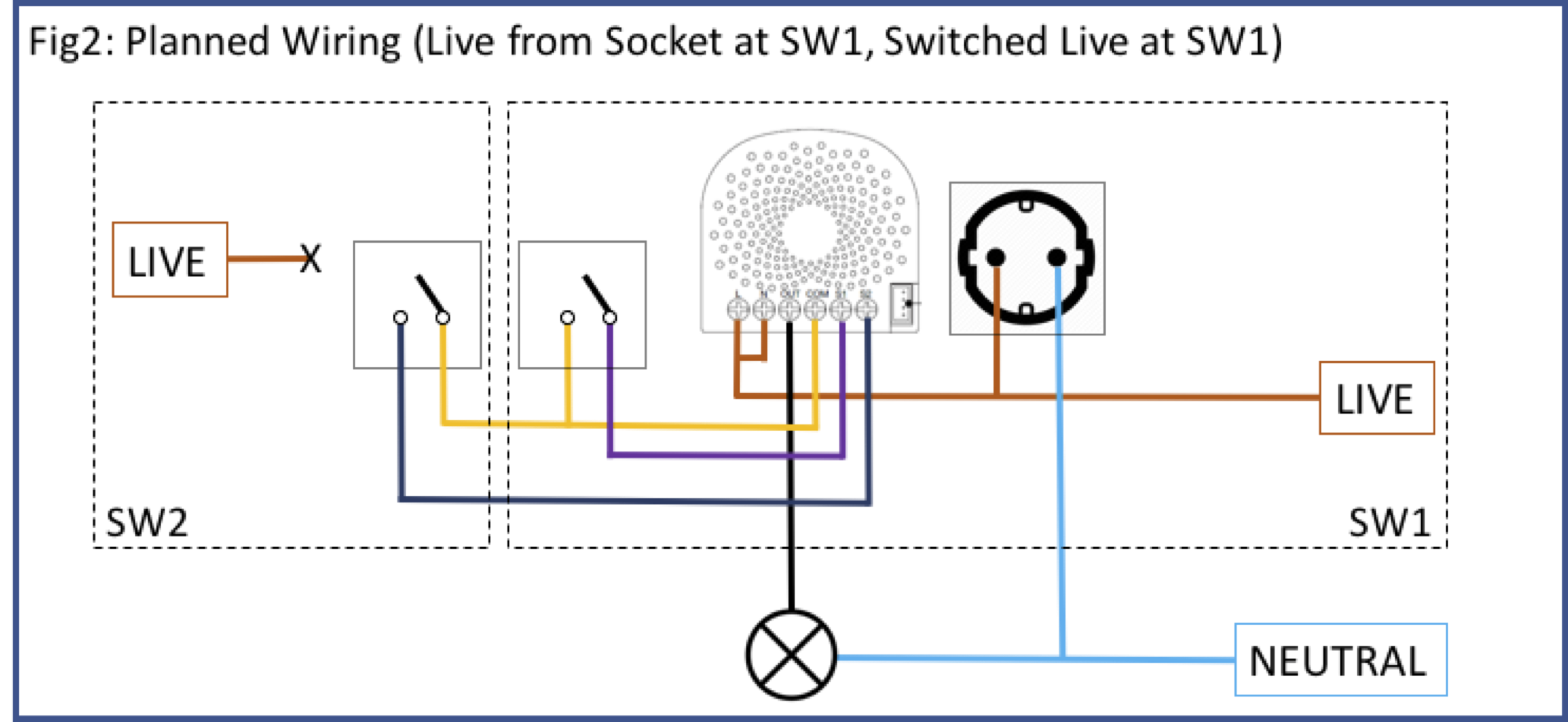

Want to replace my current dimmer/switch setup which is wired as a 'Hotel' or '2-Way' switch setup. Unfortunately, the switched live runs to a different wall point than the live. However, there is a power socket at this location too. What I am thinking is to add another Live connection here for the Nano dimmer and use this for my setup. I've attached 2x diagrams showing the As-Is and Planned to try make it clearer. Anyone see any problems with this approach?
AS-IS Setup:
PLANNED Setup:

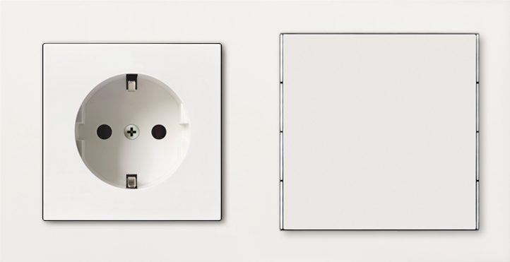

2-Gang with Switch & Socket at SW1:
