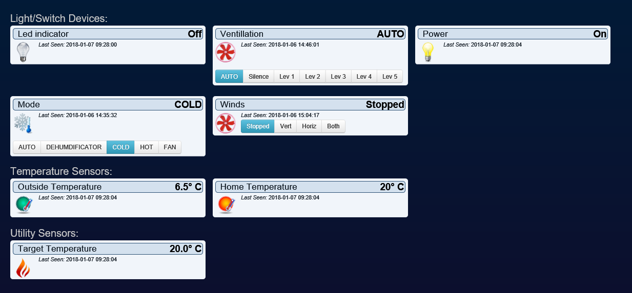

Hi All
i've made some modification to existing module, Start/Stop, Set Thermostat, Led On/Off.
Now i want add a multivalue switch, but i can't find information or sample to do that in source.
Any information for help me ?
Best regards
Re: Daikin Hardware
Posted: Sunday 07 January 2018 9:36
by spiderjn
done, need to be tested by other user.
Pull created : https://github.com/domoticz/domoticz/pull/2044
Have fun
