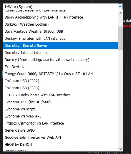

I want to send orders to my Vu Enigma2 receiver.
https://github.com/kofec/Domoticz-Enigma2
But I can't find anything under Hardware after successful installation.
I have tested the last beta and it doesn't work.
I have now installed the last stable version, and it is not possible.
Rights set to 755
What am I doing wrong?

You need to restart domoticz
then you can select in hardware : enigma2 with kodi remote
If i look in my log it does not start (errors on XML dependencies)
So just installing the .PY file is not working ( at least for my config)
Hope it helps you moving forward
