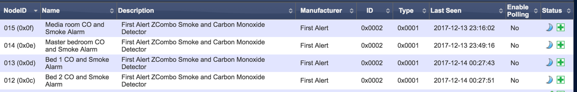

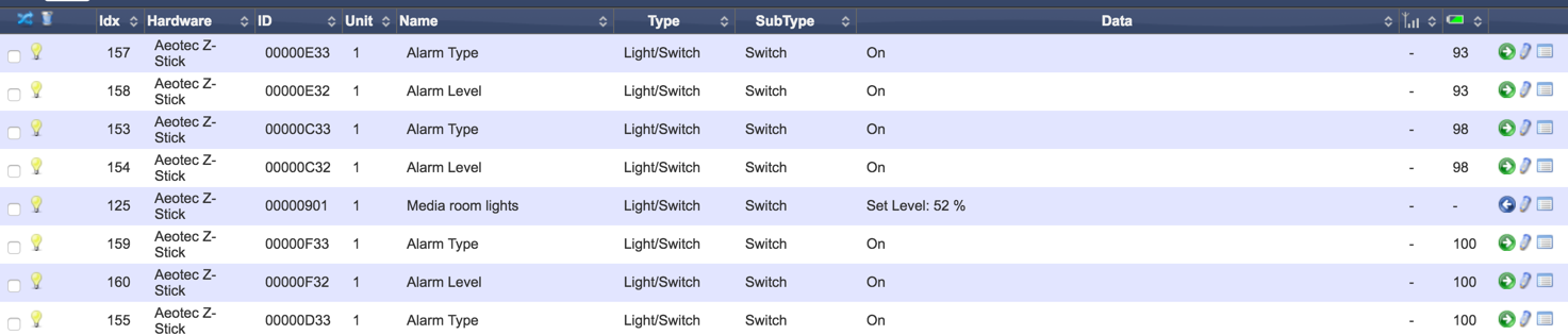

I have the Aeotec Z-Stick paired up with 4 First Alert ZCOMBO CO and smoke alarams. They have paired up correctly and shows up in Domoticz.
I want to setup alerts once any of the sensors in these devices are triggered. I have not been able to identify which device type is mapped to the smoke and CO alarms in the device list. There are 2 devices which show the battery level for each of the detectors (dont know why).
Any tips on how to set this up correctly?

the thing you're asking is probably one of the longest awaited and need feature in Domoticz. Maybe Santa Clause will bring it in 2018 :D . Short answer to your question would be:
- there is no build-in feature which would enable you to tell which devices relates to specific zwave node
- you have to manually figure out by checking hex value of nodeID and ID of device (not idx). If you have nodeID 0x0E, then roughly (probably not 100%) devices that have device ID in form *0E* relate to that node. So devices with ID 00000E32, 00000E33, 00E003, 0E0004, etc. should all relate to same node id. Which device is actually usefull for you is yet another trick. For example, I've had examples where I had two power reporting devices for same node. Few days after inclusion correct power was reported to first device and then all the sudden, correct power was reported to second device. Then I had to set first device as unused and second as used - luckily that hasn't changed back to first case since then :)

Thanks for the tip. I will try triggering the smoke alarm of one of the sensors and check which of the ids are raising any of the events.
I will post back once I get to do this.
