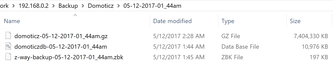

Example output:
Displays backup progress and speed:
Creates folder on the network share with contents similar to:
backup.sh

Running start.sh will start a backup running in the background, running it a second time while a backup is still in progress then displays the screen session showing output similar to that in the example screenshots above.
