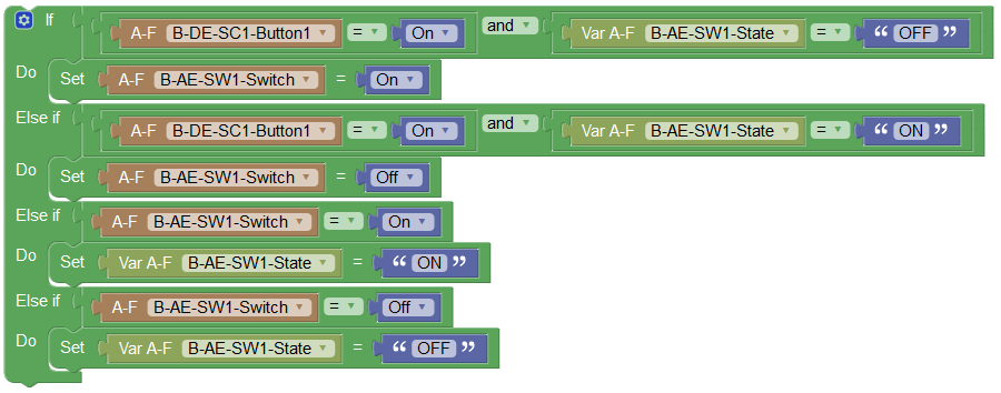

I found a way to do this, but is not really straight forward.
I defined a variable for the switch and use the value of the variable together with the button on scene controller to change the state of the switch. I hope you get the point.
IF ((button==ON) and SW1Var=="OFF"))
THEN SW1=ON
ELSE IF ((button==ON) and SW1Var=="ON"))
THEN SW1=OFF
ELSE IF (SW1==ON) #checking the status here and then only modifying the variable avoids triggering the first ELSE IF
THEN SW1Var="ON"
ELSE IF (SW1==OFF)
THEN SW1Var="OFF"
Slightly complicated to just change the SW1 to the opposite state.

- madpatrick
- Posts: 897
- Joined: Monday 26 December 2016 12:17
- Domoticz version: 2026.1
Re: Programming ZME Wall controller
Great !!
This is working for me.
