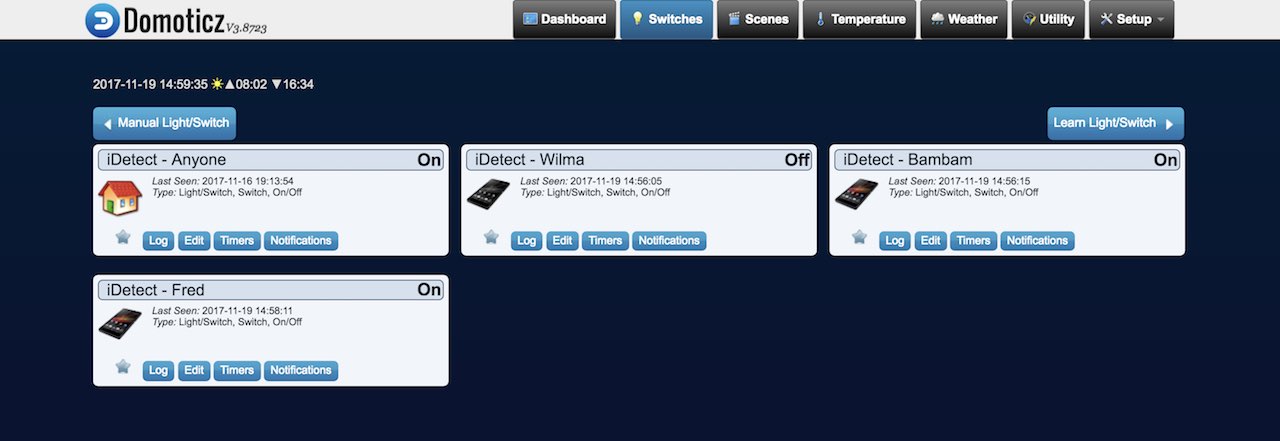

This plugin will use information from your wireless router to detect if devices (phones) are present or absent. I believe this is the most efficient way, since other methods like geo-fencing (gps) or pinging phones might drain their batteries.
You can configure multiple devices to look for by their MAC addresses. A Domoticz Device will be created for each one. Additionally a single "Anyone home" device will be created, which will be 'On' if any of the monitored devices is present.
The detection is performed through a SSH connection to your router. It supports several types and brands of routers, by detecting commands it can utilize, but probably not al. A accessible ssh service on the router is required.
Please let me know if the plugin works for your router by leaving a message in the forum containing your router brand and model. If it doesn't work, then please include a relevant portion of the Domoticz log (after enabling debug mode on the plugin's configuration page).
