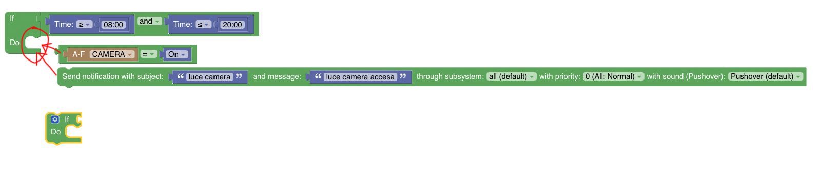

I'm trying to schedule a notification so that at a certain time, if I turn on the light I get a notification.
The problem that when configuring it as a photo, when the light is on, I receive the notifications, but I would like the notification to arrive only by lighting it up.
Where am I wrong?
Thank you
Where am I wrong?
Thank you
- Schermata 2017-11-12 alle 10.10.41.png (53.79 KiB) Viewed 2560 times

Re: notification with light on
your second if block is wrong you need the one without the blue cog

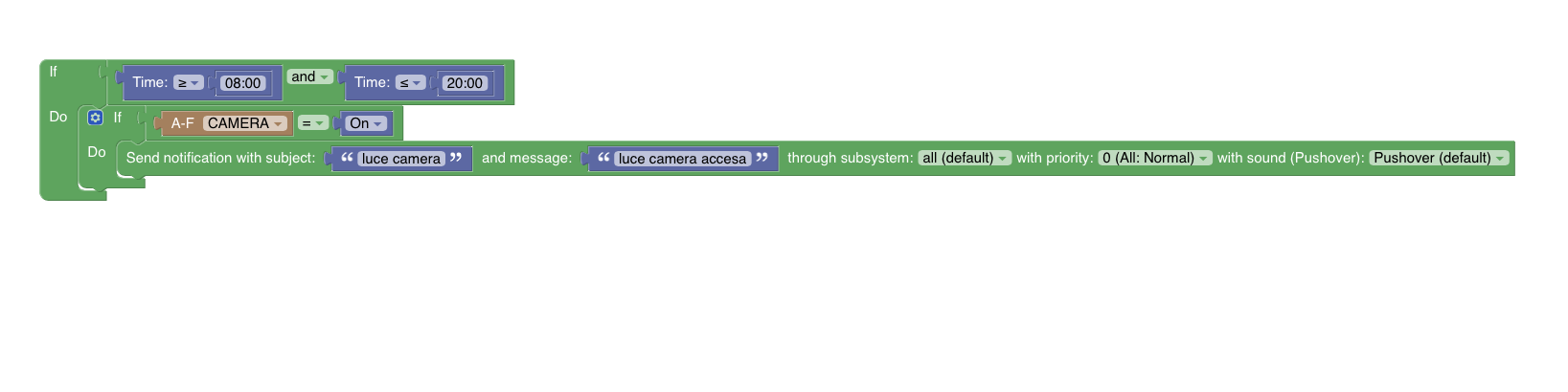

how do I enter camera blocks and notify me? what other block should i add?
- Schermata 2017-11-12 alle 10.40.41 copia.png (124.96 KiB) Viewed 2548 times
i think you need to do it like this

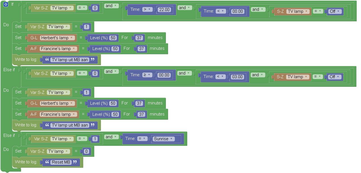

Maybe this will get you in the right direction. You have to get an user variable in to get things done.
Replace TVlamp with camera etc.etc.
You get it done. Good luck.
Greetsz,
Kuifje
Greetsz,
Kuifje
